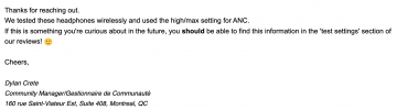

i just fired off an email to another site, rtings, i wanted to double check if they did their review properly. i am hoping they reviewed a WIRELESS headphones as a wireless headphone, not unlike here possibly.
https://www.rtings.com/headphones/reviews/bose/quietcomfort-35-ii-qc35-ii-wireless-2018
for the above headphones, i wanted to ask, the review was done with the default settings? that means:
1. wireless (NOT using the included wire, as it does change the sound)
2. default noise cancelling (there are 3 noise cancelling modes: high (which is the default), low, and off). as long as you didnt change the noise cancelling setting in the app nor press the side button below the left earcup to cycle thru the noise cancelling settings, then it would stay on the default setting (which is high)
just asking the above 2 questions because the Frequency response curve will change if the above points 1 and 2 are changed and i wanted to confirm and ask which settings did you use while you made that graph.
please let me know, thank you.

An rtings update, here is the reply i got back:
Thanks for reaching out.
We tested these headphones wirelessly and used the high/max setting for ANC.
If this is something you're curious about in the future, you should be able to find this information in the 'test settings' section of our reviews!
