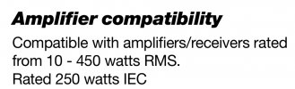

I’m not sure how Japanese power handling ratings differ from the US but the 2004 Japanese Bose 901 specifications had a 700W peak power handling!
The US Series VI (presumably ver 1) stated
How many amplifiers do you know that can put out 700W into 8 ohms?!
