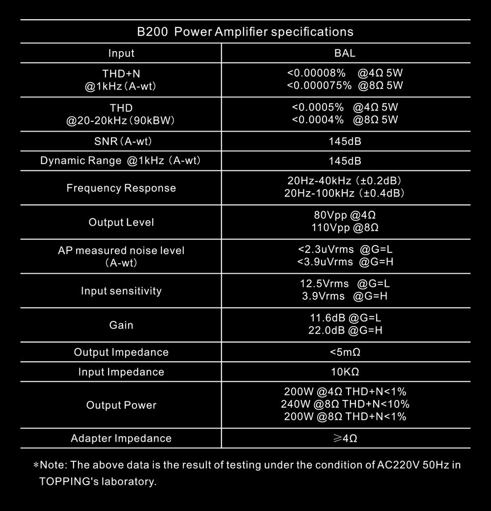

I'm thinking of getting a bluesound node icon with two topping b200 mono amps, do I need a pre amp or is the node icon good as a pre amp.
The speakers I have are monitor audio gs60 (sensitivity etc. in the picture) should I have a high or low gain setting

I haven't decided if I should change the subwoofer, I have an SVS SB-2000 today, so if I have to change it, I will change it later. But what gain should I have on the Topping B200, low or high?
The input sensitivities for the low and high gain settings are 12.5 V and 3.9 V (RMS), respectively. The de-facto standard output level of balanced XLR is 4 V, but certain "pro" focused gears can output to 24 dBu (= 12.3 V). Chances are that the Node Icon can only output 4 V (I wasn't able to find its output spec.), therefore, if you want your B200 to be able to reach full output, you'll need to use high gain. However, if you find it loud enough to listen to with low gain, you can use that too. Theoretically you can get better performance with low gain, but the differences are most likely below audibility.
