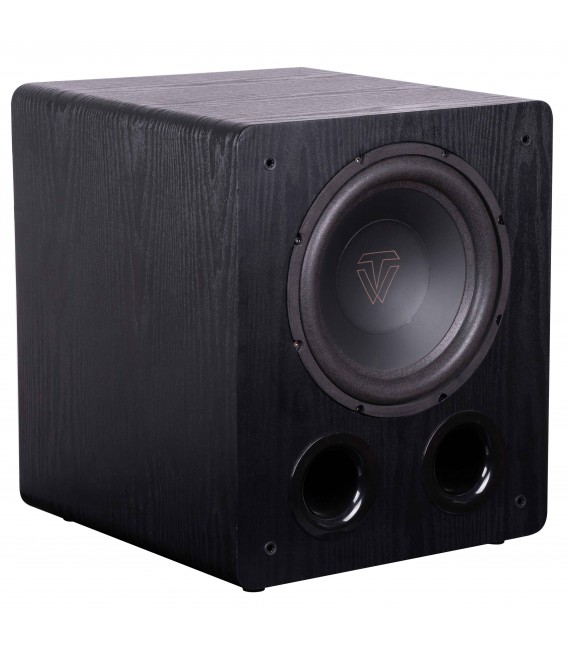

I picked up a couple of these recently, initial listening, they are comparable to the RSL 10s.
Can't get one in europe even close to $349, €298
$655,€548

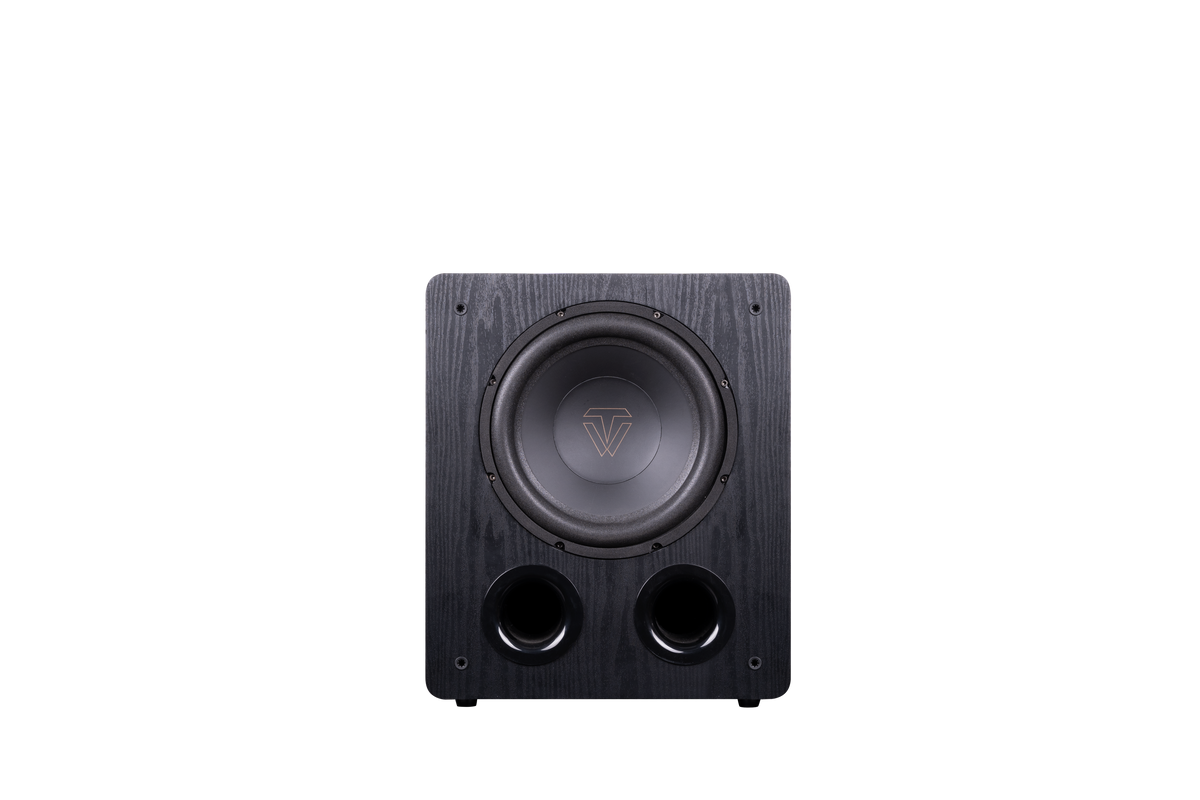

Tone winner sub is almost $500
13"x13"x6-7" ??
A tone winner 10" subwoofer is 360x432x432 (WxDxH)
Speedwoofer 10e is H: 15.5” x W: 15” x D:15 1/4”
My sub is 295x295x275 mm
