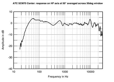

So IMO those claim of hearing more reverb in ATC I would say that's for sure given their boosted mids and the subjective feeling might very well be honest if compare side by side,
Most 3 way ATCs are vaguely V-shaped in their response, not mid boosted. It's the 2 ways that are.

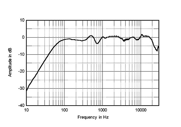

Do some of you think that all speakers from ATC have boosted midrange based on Amir’s measurements of the old SMC19 v1?
I can't see that in the measurements of their other speakers.
ATC SCM7:
ATC SCM11:
ATC SCM100SE:
ATC SCM150:
index.php
ATC SCM70:
YSC
Dec 31, 2019
3,194
2,570
ah ~ ok, that's my bad for assuming that the old one is kind of the ATC house sound which I expected should be consistent for say the B&W, Adams or the Dynaudios throughout their range. it can then be due to internal resonance/echo/ uneven off axis response creating that sense then
