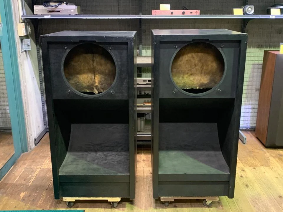

Here is what I found near me in Sweden. If I can find something like this, surely you— @Mort —could find something similar used in the US (where you live?):)
According to the ad: Well-built 4530 horn copies.
No bass drivers included. $210 for both cabinets.
They probably score highest on the WAF scale, but I’ll leave that aside.

Suitable bass drivers would obviously be JBLs, but I suspect that any good 15-inch bass drivers with the right Thiele-Small parameters—from brands like 18 Sound, B&C, LaVoce, Faital Pro, Eminence, etc. (i.e., pro PA drivers)—would work.:)

They certainly aren't pretty to look at, but that can be fixed—with paint or something else. They are hardly small bookshelf speakers; that becomes clear from this video. I don't speak Italian, so I don't know what is being said, but you can watch the video to get a sense of the size. Incidentally, this applies not just to these, but to all horn speakers if they are to reach reasonably low frequencies. They end up being large—it’s simply in the nature of horn designs::)
