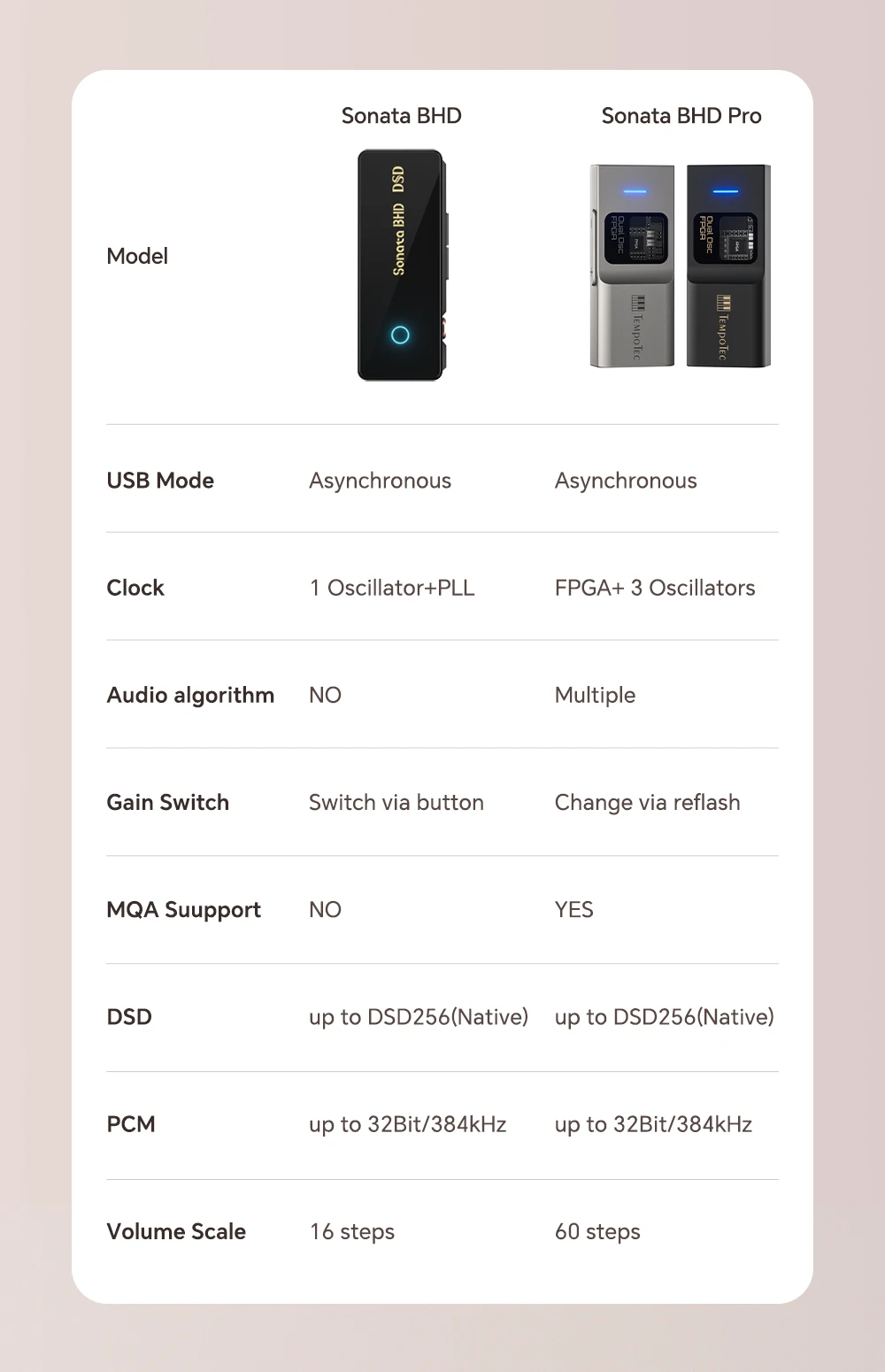

What about Tempotec Sonata BHD? it is dual CS43131 with 3.5 and 4.4 outputs for only 30€ on Aliexpress, is it as good as other dual CS43131?
Seems really good for the price I think, but no reviews about the non pro model. This is not old BHD with 2.5mm output, this is apparently a new model?

Tempotec proved to be reliable so far and the BHD should be as good as other dual CS43131 dongles reviewed here, it seemes even more appealing than the Pro version to me due to less frills and being able to change gain manually instead of messing with firmware reflash, and 16 steps volume is not a concern in my case since i hardly would use them (I don't like at all volume buttons without a display showing at what level it is set)

All this talking about dongles made me hungry and since special sales end tomorrow I finally ordered a Sonata BHD DSD, don't need it but for €34 it can't go wrong and in the end I'm too much an 43131 aficionado. So finally I can use that 4.4mm modular cable i got long ago just in case lol.
