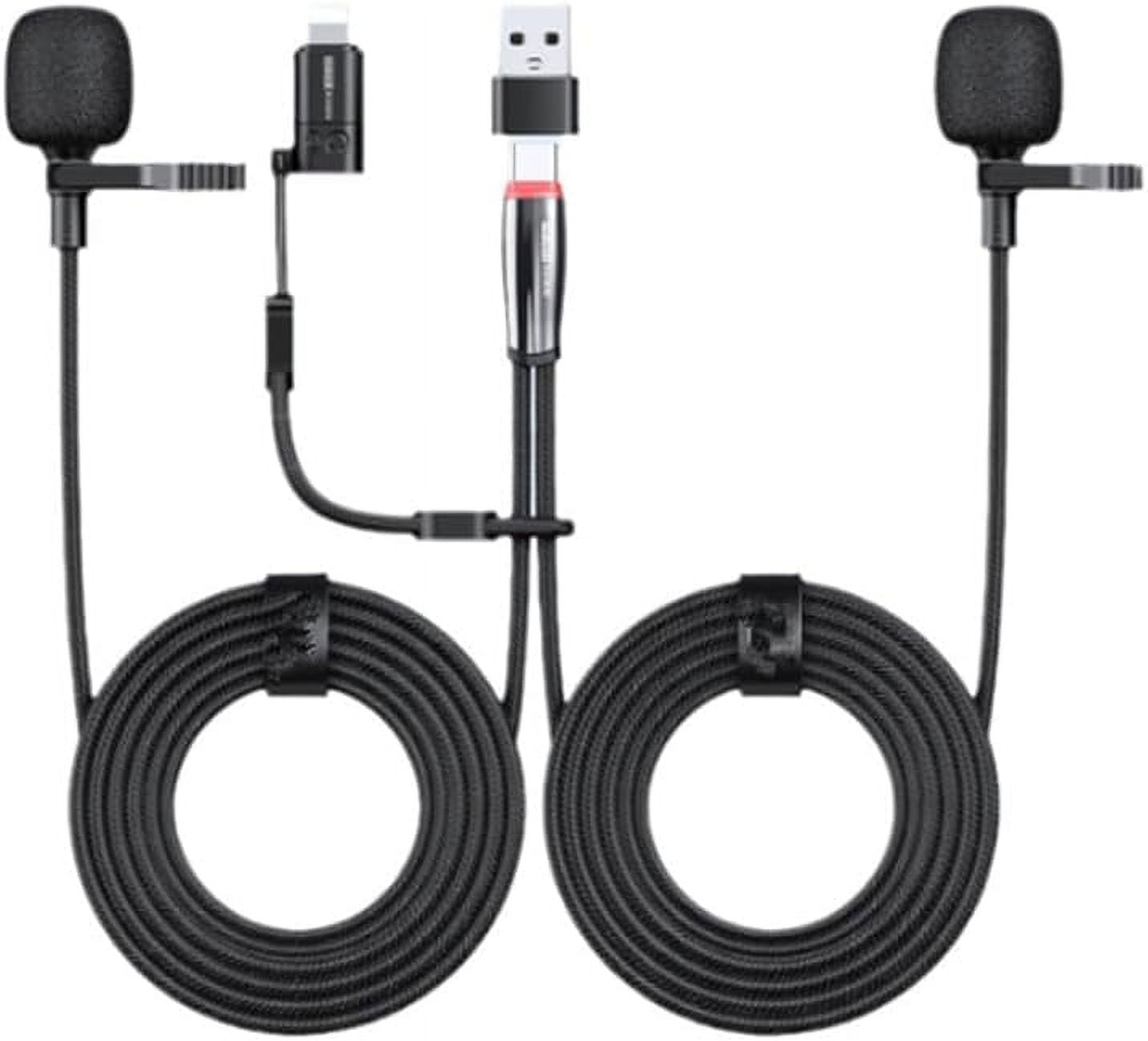

Do anyone knows what this CB1200AU chip is and it's advertised EQ functionality?
https://it.aliexpress.com/item/1005007343019376.html
this is what i could find, but seems that it is and ADC, not a DAC. I would be wary of that thing actually being what it claims:
here a dongle that claims to use it, and it is a two microphone (ADC) interface:
Thank you for the info! It indeed seems to be a 2 channel adc chip. The dongle advertising is a total mess, probably not unwanted, with EQ function bait. If we read carefully they say "supports SOFTWARE eq tuning"... well, as much as any other dongle lol, so technically you can't blame them for scam, how tricky.
There is also a video that is a total chaos, rapidly showing al types of dongle, CS, CX, ALC and manufacturing steps at random :facepalm:
Well, stay away.
