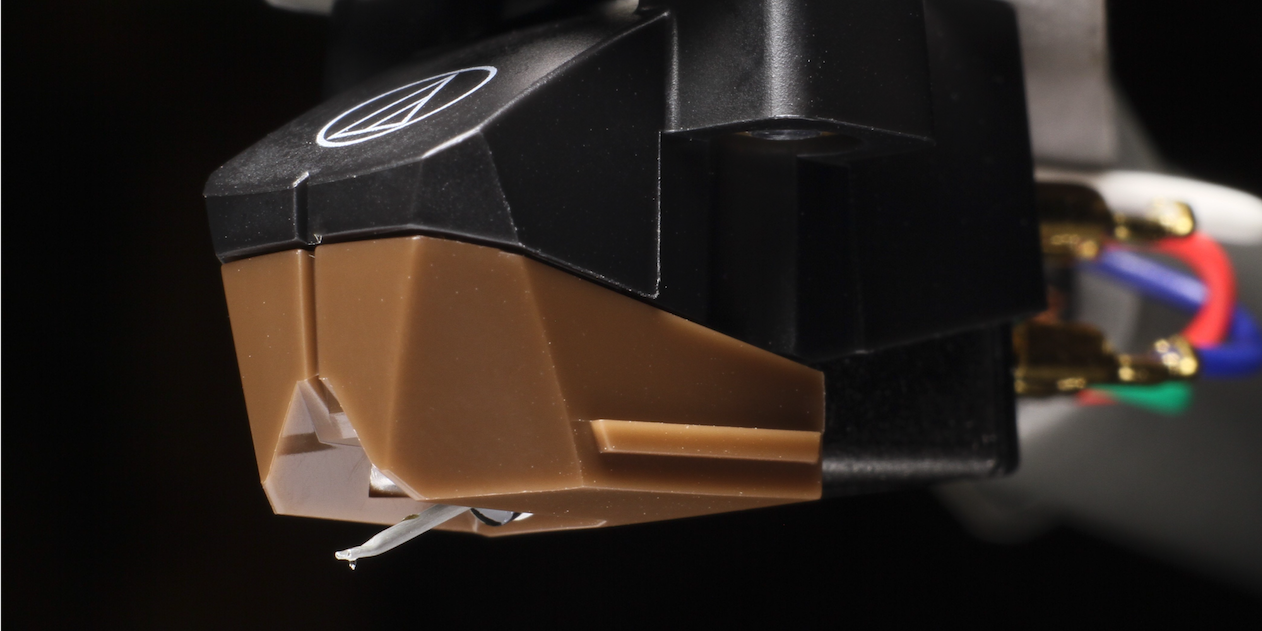

  • The most tested seems to be the AT VM540ML which seems to be the sweet spot of good measurement vs price

Yeah... ive been looking at that thread specifically at the audio technica segment vm95xxx, vm540/740ml, nagaoka pearl, sumiko 100/110 parts. its just that i did not see a general consensus on which ones are the "best" for their price point subjective wise. I wanted to get the maximum out of my turntable as most of my records are just japanese city pop records since i like to chill with them at night. I am definitely going to look for vm540/740ml cartridges as a good upgrade. thanks for the tldr of the threads!
The VM95ML seems to be a firm low cost model and a big step up from the 95E (all ATs with bonded diamonds tend to be a little 'closed-in' sounding to me, easily audible when compared to the better-tipped models in each range). It's apparently longer lasting too. The 95SH should sound a little more 'subtle' up top, but the generator system then starts to get in the way I'd suggest with lop-sided separation as measured over the decades. The VM500 series offers posher wiring and better internal construction and shielding I believe.
The VM540 does seem to be the next step up and the average 'technics' tonearm always seemed happy with the ancestral 440MLa model. The 540 tames it's ancestral toppy-peak a bit and the 2g tracking helps these older massier arms in terms of stability I'd suggest. The related metal-mount 740 could also be considered, as the 'tone' is slightly gentler (all else the same I believe including the stylus assembly).

Thanks for the insight! I can't decide between the vm95ml bnew or the 540ml second hand (10 hours used as said by owner). Ortofon seems to be a generally good cartridge but is it better than the audio technica mls ?
"better" is a great subjective term :)
what is totally objective is ... Ortofon is pricier than AT for the same "features" ... i mean, the first fine line stylus cut is the bronze at almost double price than vm540ml.
I decided to buy the AT vm540ml.
There're some "details" about it ... AT needs low capacitance (low capacitance rca cables and phono preamp) and Ortofon doesn't need it (works with higher capacitance).
So, i bought short and low capacitance cables and my phono preamp have 100pf capacitance.
That's my "experience" and let me say a final thing: people that wants the "old" cartridge sound (recesed mids, pronounced bass) look elsewhere ... this new cartridges / fine line styluses have a flatter response (more "digital" to say it quick). And i love it, now i can listen to vinyl as what recorded and i can do eq if i want it, but without any previous frequency loss because the cartridge have a 70s eq included :)

The 95ML - to me - is a crisp (but not acidic) and lively balance and at retail prices, an excellent value pickup. In today's digital world, the VM540 is roughly where, fifty years on, the once ubiquitous M75-ED would be. Lowbeats tested it and posted sound-bites if you care to use a translator and look it up. I've not 'heard' a VM740 but the slightly 'gentler balance and metallic mount appeals hugely to me, knowing my Dual 701 tonearm as I feel I do after half a century.
If you can get a guaranteed low-hours 540 for half or two-thirds price, I'd grab it I think.

This really applies with your Fosi X5 because it has come to light that it has 150pF input capacitance. That makes it very difficult to stay under the 200pF recommended max of the VM540ML. Sure, you can go over that a bit, and it might not really make a huge audible difference, but it would be ideal to have a phono amp with lower input capacitance. I would recommend the VM95ML (as an owner of both cartridges), as it is not as sensitive to capacitance and it won't be a problem to be a bit over 200pF. You'd still want low-capacitance RCA cables.
I don't believe so, based on what I've heard. The Bronze and OM30 are nice, but they are way over your stated budget of $300 (~$400+ USD), and anything lower than those (2M Blue, OM20) are bested by the VM95ML, IME. The 2M and OM20 do sound pretty good, but they are elliptical will suffer IGD with some records, which I personally can't tolerate. I would still take the VM540ML over all of them in my set up, but in your case...

Is capacitance different from input impedence?
It's part of it.
Z_in = R_in || 1/(jωC_in)

Since you have the VM95E already, I would strongly consider getting one of the fancier replacement styli for it, like the VMN95ML or VMN95SH. They should all be within your budget and seem to be very nice-sounding. The minimum to these ears would be the EN, though supposedly it may be subject to early wear or something?
The VM540ML does post even better measurements, the only negative I can find is it being a bit hot in the upper treble (experimenting with loading may address that, ATs traditionally tend to like lower capacitance and/or lower resistance; the latter is a proven approach if you cannot possibly reduce capacitance even more, though it does bring down the upper bandwidth limit somewhat).

Thanks for the tip! I might get the vm540ml second hand @ 10 hours simply because its at the same price as the vm95ml in the future i will replace the fosi phono preamp with lower capacitance one
