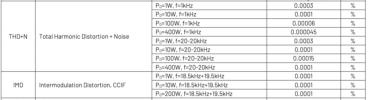

not sure where you saw 55db SINAD for Purifi tbh ... see Purifi official data for 9040 module and I am driving them with my Benchmark LA4 pre-amp in cleanest possible bypass mode (no front-end buffers in the signal path)

The spec sheets from Purifi and hypex are measured based on a bandwidth of up to 20kHz, where as Amir does it up to 45kHz.

Didn't you say that at 15KHz performance is dropping to 55db SINAD? Or maybe I misunderstood your post? In Purifi 9040 specs I just posted, I see nothing like that ... 20Hz - 20kHz

I believe those measurements are with front-end buffer boards in the signal path and with 20db gain settings ... Purifi alone has 14db gain and shows clean performance between 20Hz - 20kHz ... on the other hand, on that thread, AHB2 measurements were done with lowest 9db gain setting, which has the ultimately best measurements ... again not denying Benchmark's fantastic engineering, but also saying that Bruno Putzey should not be dismissed either. Otherwise it can sound clownish.
Both Hypex and Purifi datasheets use 20Hz-20kHz BW to measure THD+N. Thus, above 10kHz fundamental frequency THD+N plots show noise only. It is for the marketing reason, the plots look much nicer, then. Such measurements are pointless above 10kHz. Totally. They started to be used with class D. Before, 80kHz BW was a standard to catch 4th harmonic of 20kHz.

From Hypex. Purifi does the same exact thing.
The bottom line is this: the distortion and noise above 20kHz is inaudible, that's why Hypex and Purifi only uses bandwidth up to 20kHz. Amir goes up to 45kHz because Amir is a nut job like me, we are marveling at the engineering feat.

When I see that my Purifi power amplifier board has clean performance 20 Hz - 20 kHz, both THD and IMD below 0.0001 % should I be really worried? Let me know

No, your Purifi amp is excellent, I have the Hypex, that too is excellent. Unless you somehow mutated to a bat and you can withstand extremely high SPL for a sustained long period of time without losing your hearing, then there is absolutely nothing to worry about.
