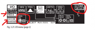

DOes anyone know whether DEQ2496 can passthrough Dolby Digital/DTS. I dont need to EQ signal passing through, just that it passes.
I tried enabling bypass on DEQ2496 but it looks like it does not pass
Maybe a setting somewhere?

Just checked my own deq2496 and in I/O section one can't select mic input as a source for output.
And how to engage passthrough? I used "bypass" button but it didnt work. Toslink to toslink.
Dig in MUST be switched to dig out/aux out, dither OFF, noise shaper OFF and select S/PDiF.
Bypass button doesn't matter becouse 'dig in->dig out' is completely independent route.
Tried yesterday, it didnt work. I am not so concerned anymore as i put a toslink splitter before the deq and bypassed deq for the avr.
