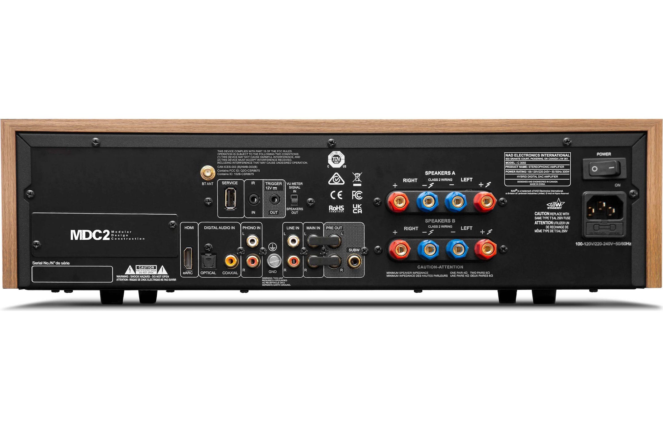

Looking at the back panel of NAD C 3050, it has a pre out as well as a subw. Might it make sense to connect one sub to pre out and the other to subw? Is DIRAC able to control those independently?
The pre outs need to be connected to the internal power amps. You cannot divert one to a subwoofer and still use it for the internal amp.

Did that and Kal is right, it has to be connected to main in as it is on the picture above :D This option was always too good to be true.

I might be missing something but this particular BluOS module doesn't seem to have extra sub outs.
MDC2 BluOS D
