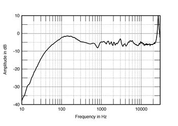

Here are some basic measurements of the B&W Silver Signature 25 speakers;
Fig.7 B&W Silver Signature, anechoic response on tweeter axis at 45" averaged across 30 degrees horizontal window and corrected for microphone response, with complex sum of nearfield woofer and port responses below 300Hz.
Looking at the manner in which the B&W's response changes to the speaker's sides (fig.8), the relatively large-diameter woofer becomes directional in its top octave, resulting in a suckout off-axis at the exact frequency where it peaks on-axis. Though the discontinuity between the woofer and tweeter dispersions at crossover is not nearly as marked as with the Velodyne DF-661, the room reverberant field will lack presence-region energy. This will reduce the audibility of the already slight on-axis peak at 3kHz; but, all things being equal, it will also tend to make the speaker sound rather polite, lacking in treble bite.

There is something to be said for nostalgia, but I tend to agree with @MattHooper that if you're in the market for bookshelves, there are numerous well-regarded options that are more technically proficient, or shall we say up-to-date.
That said, I had some B&Ws almost as old as I am (>30y) and they didn't sound half bad to me. If you are looking to go down memory lane with B&W my advice is to take a nice long walk. Over the past 20 years I think they've gotten progressively less neutral in favor of what you might call showy, splashy, or "showroom" sound.
Even though this model is a bit off-kilter I think most speakers they're putting out in present day are even MORE askew.

Or on a more practical and not terribly expensive front, I have some 602 S2s in my guest room and I think they're probably not far off, on-axis, from what @JSmith posted. And they're not that hard to find secondhand.
