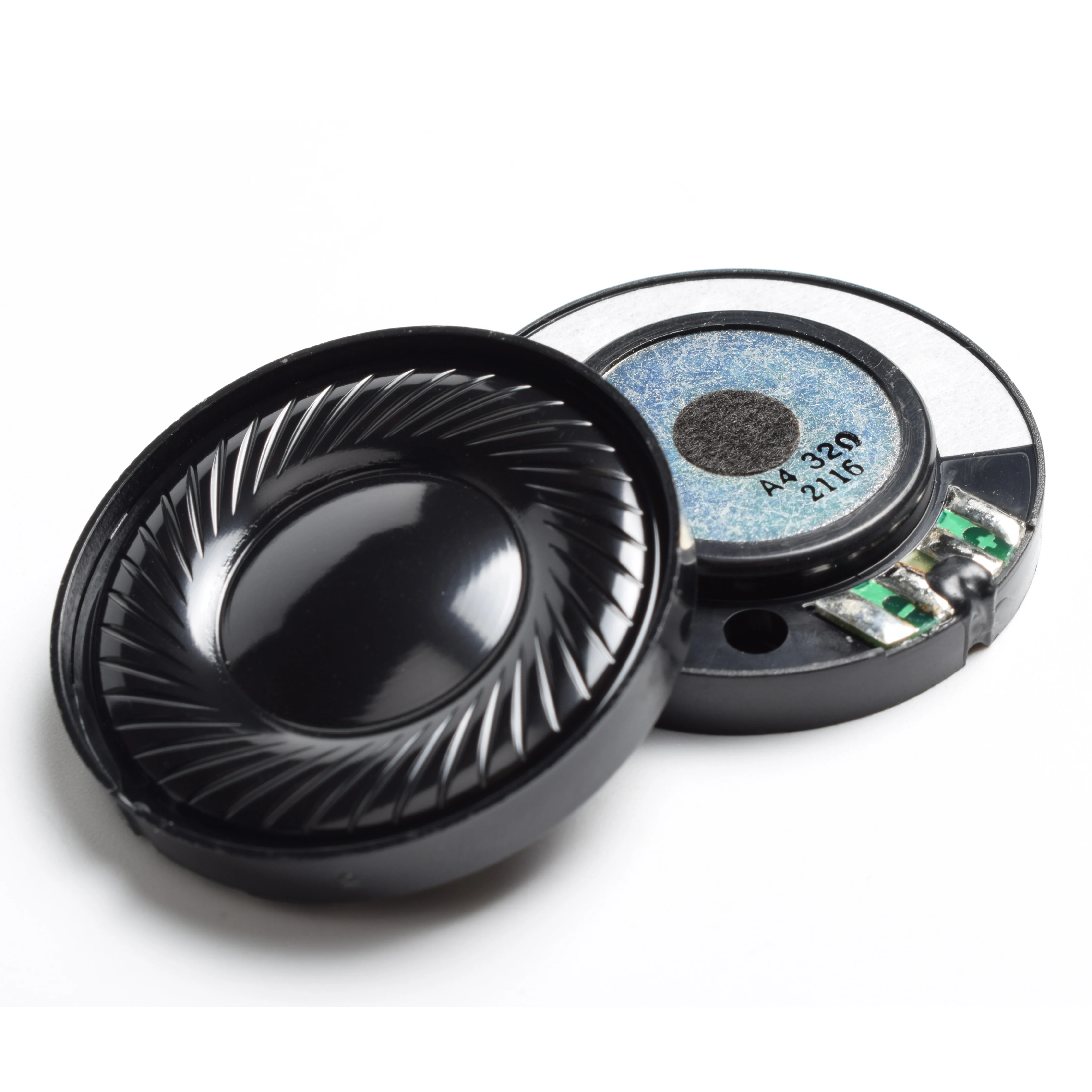

There was a lot of controversy around the Borealis when it was launched, because it uses $10 drivers from Peerless (HPD-50N25PR00-32).
Good to see that this doesn't impede their performance too much. Yet another case of price ≠ performance.
(The price of the headphones themselves is another story though)
Important to note that dynamic drivers in general are dirt cheap. $10 is already on the expensive end for a headphone driver. I'd be surprised if many dynamic driver headphones under $1000 had drivers that are much more expensive to produce/procure. A sizable portion of the cost here is likely to be the injection-molded parts, as that becomes very expensive on smaller production runs.
Which premium mfr does use drivers higher than 10$????
The vast majority uses drivers from Mylar that cost 1$/each in lots of 1000s.
A new HD 600 driver is about 30% the cost of the headphone.
A new DT 900 Pro X driver is about 20% the cost of the headphone.
A new K701 driver is about 20% the cost of the headphone.
A new Borealis driver is about 1% the cost of the headphone.
I hope you see the disparity.
And yes I'm aware that the first three are inflated OEM prices and that they cost far less to produce.
But those are simply the prices that a customer is confronted with and that was what sparked the controversy among customers.
It was about implied value, not actual value. Aurorus could've rebranded the Peerless driver and charged $150 for a replacement and noone would've complained, as that would've made the driver "of appropriate quality" for the MSRP of the headphone, in the eyes of the consumer.
