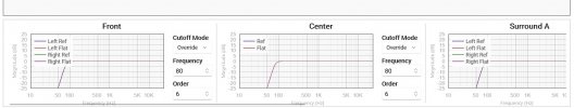

Below are 1st pages from both EQ-x APP and REW test 1/12 smoothed. All my channels look 99% like the first speaker except the Sub of course. I spent months trying out every conceivable option. In the end after testing results through REW this is what gave me the flattest response. Note that I have 2 subs and I run the range from AUTO to 100hz. I do not like the sound when you try extending the range of the sub too high. Also note that Auto to 20khz should be the range for the rest of the speakers. I find that only "AUTO" to 20k works properly. The sub slope should be disabled for best results. The rest of my speakers I Override and slope at 6 and cross at 80hz. The suggested crossover points that the app recommended did not provide the flattest results.

Looks like you had the same little rise in response at the very high end that I was hearing in my system. If you hear any graininess with things like female vocals, I recommend trying a small shelf of about 1.5dB at about 15-17kHz to very lightly roll off the highs a touch. I also use Flat, but that little minor cut did a lot to tame things with my speakers. Just throwing it out there.

Why are you specifically looking for the flattest response? Flat at the listening position actually boosts the high frequencies of the speaker, so it's not actually flat (a speaker that is flat near-field will have a downward slope at the listening position, see all of Amir's speaker reviews, Harman listener curves and such). But I guess if it sounds better to you, then that's fine. Nevertheless, nice to see that Audyssey is effectively capturing the desired response. You can also create additional filters in REW that MultEQ-X can import, if you want to fix that rise after 10k.

Maybe have a look at the Harman preference curve. It is the result of an anechoically flat speaker when played in a real room. It usually exhibits a slight bass boost and a slight roll off of about 0.5 to 1dB per octave depending on room. I usually let Audyssey „follow“ the natural roll off of the room. Or disable it above Schroedinger. A flat in-room response instead is by many people perceived as too bright and lacking of bass.
But please don’t take it as criticism. If you prefer it the way you set it up, that is all what counts.
It’s not “correct” but a simplification that’s as likely to hurt (as in, sum less cleanly than optimal, rob headroom) as help. You missed the point, which was the part you didn’t quote. The theoretically (and IME actually) better approach is, as @Sancus wrote above:
