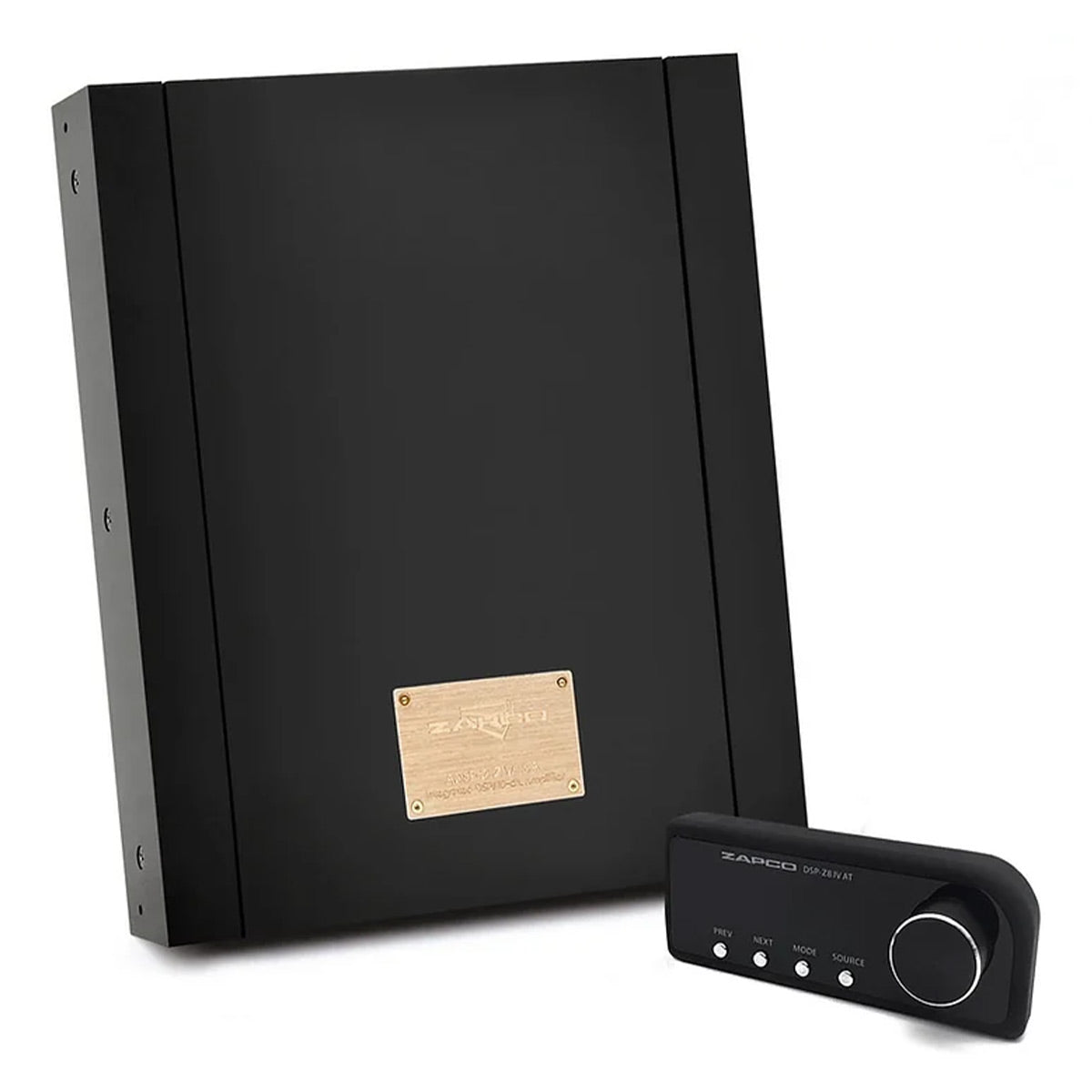

Before you make the final decision…
Zapco HB-410-ADSP 10 Ch. DSP / 8 Ch. Class D Amplifier​
Much much cheaper.
It is a nice piece/option for $360
Downsides are only one set of RCA inputs so the headunit losses the ability to control any fading, ect.
and power is fairly low, rated at 20wattsX8 @4ohms and 35x8 @2ohms.
Looks like it can be programed with iOS and Droid.
The software may be similar to the Dayton Audio DSP, it looks familiar.
Hard to say but it is a decent looking option
Much much cheaper.
I can hardly find anyone using it online. Are there any reviews of it?
I downloaded their software. Seems fine for my use but not nearly as capable as the Audison under review.
Seems pretty decent, wish distortion was better but noise floor in cars is not comparable to normal living rooms so I wouldn't personally worry. And at 14ch with robust DSP the price seems fair. Not apples to apples but in terms of channels and capabilities it's not far off from an AVR which wouldn't be cheaper.
