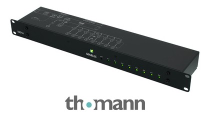

So, to recap, from the VP to the 9301A:
AES1 Out -> AES In 1
AES2 Out -> AES In 4 (LFE)
AES3 Out -> AES In 3
AES4 Out -> empty (no cable connected).
Please confirm if this is correct.
Is this right then? Where is the center?
Typically...............
AES1 Out is Lf/Rf
AES2 Out is Center/LFE
AES3 Out is Ls/Rs
AES4 Out is Lr/Rr
AES1 Out is Lf/Rf
AES3 Out is Ls/Rs
AES4 Out is Lr/Rr
Thanks. I too would have thought. But here is the Genelec 9301a diagram, which specifies LFE for AES4.
I should contact them probably.
