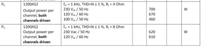

Strangely icePower states (a little) different numbers despite the PFC.
Where is more evident is efficiency:
Edit:
Where is vastly different is between 230 and 100V mains,240 watt less for the later for both channels driven at 4 Ohm.
But as to original question of course and adapter can change nothing.
