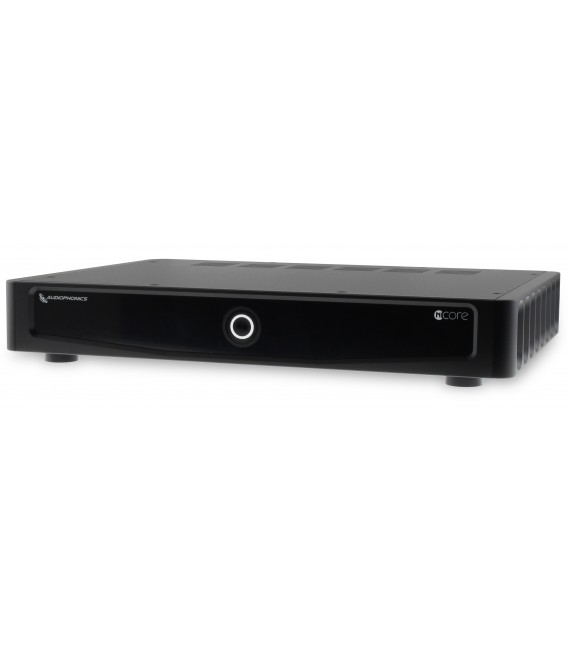

Lots of empty space in there. I wonder if the long depth is for a rack mount? Or what?
They standardize on 2 boxes, basically.
This one and a full width one.
This one is also used with a stereo Purifi inside.
More crowded then...

I have had one of these since January 2021 hooked up to my Denon AVR-X3600 to drive the front L+R speakers (Elac DBR62), in bypass mode, allowing the Denon to focus on the centre, subwoofer, and rear surrounds. Absolutely great compact unit, no faults, and sounds really nice. As Amir mentioned it does get warm, but not concerning, and I initially had it in an enclosed space (home TV stand) before realising that probably wasn't the best for the life expectancy of the unit.
I have the smaller NC252MP (2x125w/4R) version, and plan to buy an other one to multiamp (with active dsp crossover) for a system i have. It's great, basicly transparent and very reliable for whatever speaker i connect to it. It just lack colour for the systems i where i want that (but i got other amps for that). It's a no brainer if you want a clean amp. Purifi and more modern Ncore variations may measure better, but this is already beyond our hearing limits...
The case is very basic and rough, but i don't care. And the power led is way to bright (but easy to mod). But the build is high quality with good quality connectors and build like it should. The measurements are what i expected, so no surprises. But thanks for finally measuring those.
Very good performance. I am left to wonder where exactly the low impedance protection triggers the shutdown. It is shown to be between 4 and 2 ohm. However, many speakers do have impedance slightly below 4 ohm and it would be useful to know the threshold when protection kicks in.

Still, the infinite spray of mains harmonics suggests the wiring/grounding scheme could be improved and probably the XLR version has less of it. From the photo shown we can see that the form factor would have called for a 90° CCW placement for best cable routing.
But it could be mains contamination is intrinsic as the input section is really damn close to the power supply, not exactly best practice.
I built a couple of these with balanced inputs and see none of the harmonic spray measured in this review unit.:cool:
My power measurements are very comparable to Amir's.
p.s. should note that the harmonic spray mentioned is mainly below -110 dB
No surprise here.
