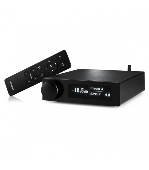

It is true that if you want to use DSP I think what audiophonics wants to tell you is that in the end it finishes with the DSP dac. I would strongly simplify the chain of components.
Digital streamer/dac - DSP - amp plus sub
I would process the volume with the DSP.
Read the administrator response here
Then you should know that speakers and room will create 70% of the sound. The ncore and purifi amps can be considered as perfect and almost zero influence on the sound (which is good).
What is good if you use the DSP is that you can tune the subwoofer speaker filters very well and you can add some correction - eq.
So you don't need a second preamp, basically you just need to set the subwoofer volume at something which is ok with 80% of the music you listen. Same with the main combo pream-amp.
Then you adjust the volume with dac or DSP. I suggest DSP as it probably does it better.
I personally feed directly the purifi amp with no buffer with the rme, and the rme main cursor is between -20 and -10 dB. No pre amp, no buffer.
With the high end audiophonics buffer, you can choose a gain which suits your needs and get rid of the preamp.
I have never tried beyer. I am afraid of the highs pick... the Neumann is fine and neutral. I had a hedd which was great but very big.
This box could be the all in one you need.
And a 400€ ncore would be enough if money is an issue.
Thanks again. The 4 in would be in the context of leading from the dac. But the mini dsp is clearly a more efficient and logical approach. I’ll probably end up going with that.
