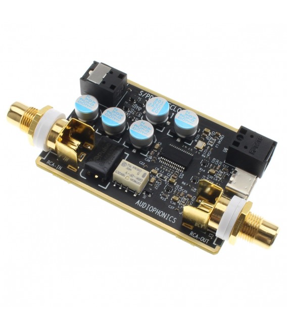

Just bumped into this product released today:
Could this have any audible improvement or is this just yet another variant of snake oil (like the iFi products...)

This SPDIF Reclocker was designed and developed as a solution to issues many customers have faced: SPDIF with interruptions, discrepancies, no sound at all…
Until recently, the error margin to receive SPDIF signals was wide enough to accept any kind of signal, whether it was clean or not.
DACs and recent amplifiers now produce extraordinary measurable performances and require an input signal that is both high-performance and stable.
It is exactly what our DIGIRescue offers, as it is mainly designed for old SPDIF sources (TV, CD players, old DACs…) with an poor SPDIF signal and/or synchronization.
The point is absolutely not to reclock the SPDIF output of a DAC or any other kind of modern interface, as they already are well-synchronized and clean.

I cannot say about the reclocker. But it seems that there could be some needs for it, assuming the response from @Audiophonics above.
Glavanic isolation through coax, tho... this could be needed for some poorly designed DAC that are sensitive to loops on that input (while immune through toslink, obviously). Here is an example I measured:

Hey @Audiophonics questions about this product.
  • I’m experiencing brief dropouts with the Topping DX5 II DAC from multiple sources and through both optical and coax inputs. I assume this is the kind of problem the Digirescue is designed to solve?
  • If both optical and coax signals are present, which one is selected?
  • Is the selected input always present at both optical and coax outputs?
Thanks!
