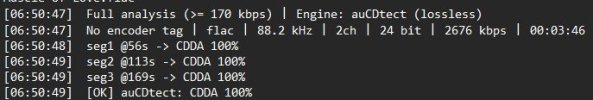

@Alessandro Comito I thought auCDtect could only process 16 bit 44.1kHz file, I see it shows as the engine used on some of my 24 bit 88.2kHz files. Can you please explain?
Updated 2026-07-01

Can you attach the log recorded in the ~Report folder?
Actually, since I don't have 88.2 kHz audio files, I couldn't establish completely reliable thresholds.
Generally, an album can have some tracks that are clean and others that are fake if they contain lossy material, even if they come from CDs.
