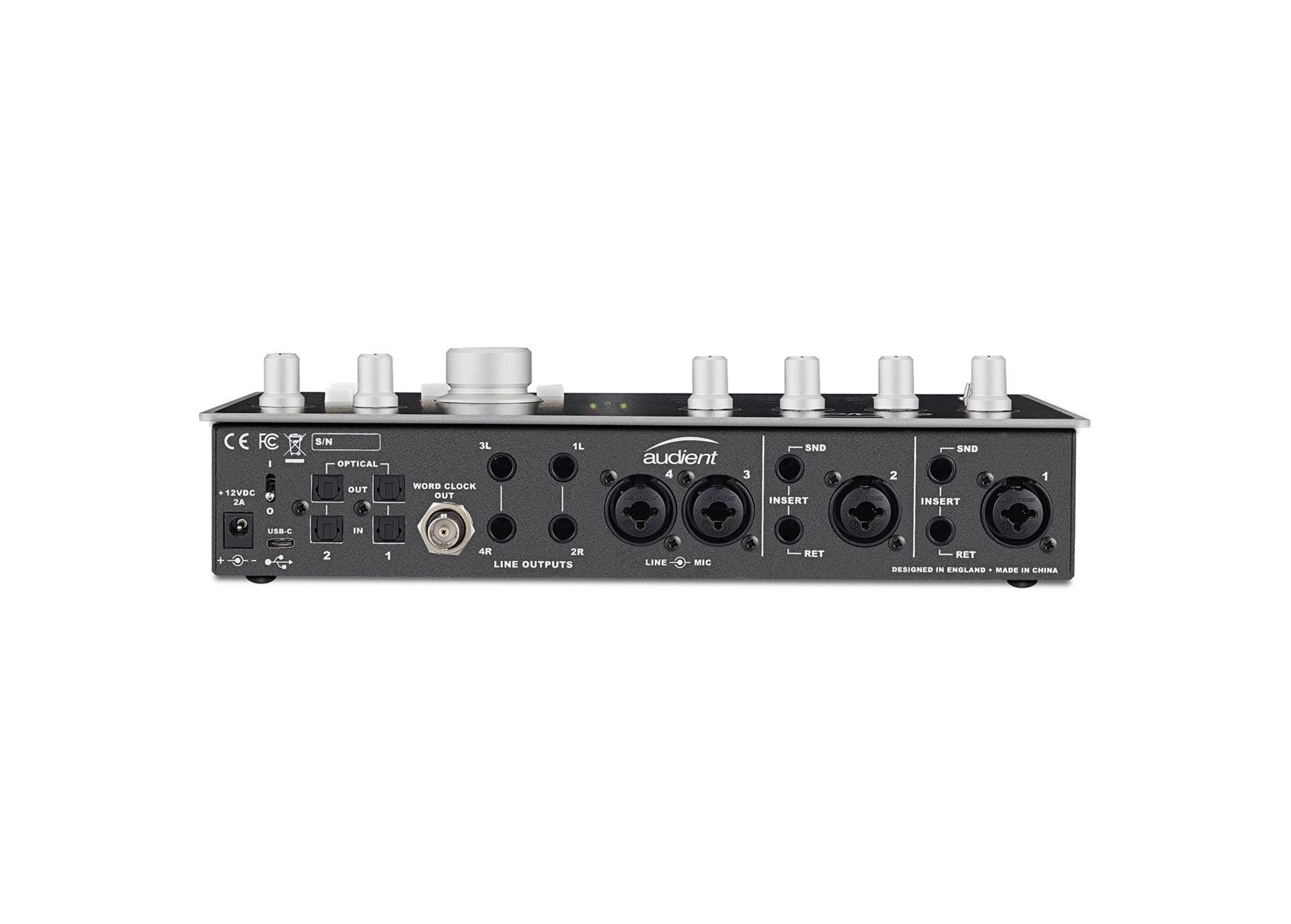

Audient id44 review​
Specifications​
Microphone preamplifier
MIC GAIN:0 to +60 dB
LINE GAIN:-10 to +50 dB
PHANTOM POWER:48v +/-4v @ 10mA/Channel (12VDC only)
MIC EIN:-126dBu
CMRR:>80dB @ 1kHz
MAXIMUM INPUT LEVEL:+18 dBu
INPUT IMPEDANCE (Mic):3k Ω balanced
INPUT IMPEDANCE (Line):10k Ω balanced
FREQUENCY RESPONSE:±0.5 dB 10Hz to 65kHz
CROSSTALK:<-90 dBu @ 1kHz & 10kHz
THD+N @ 0dBu (1kHz):0.003% (-96dBu)
SNR:96dB
XLR:Pin 2 (Hot), Pin 3 (Cold) & Pin 1 (Shield)
1/4” TRS JACK:TIP (Hot), RING (Cold) & SLEEVE (Shield)
D.I / Instrument Input (Channel 1):
D.I GAIN:0 to +60 dB
MAXIMUM INPUT LEVEL:+10dBu
INPUT IMPEDANCE:1MegΩ Unbalanced
FREQUENCY RESPONSE:±0.5 dB 10Hz to 50kHz
THD+N @ 0dBu (1kHz):<0.3%
SNR:95dB A-weighted
1/4” JACK:Tip (Hot) & Sleeve (Shield)
Analogue to Digital Converter (ADC 1 & 2):
(Measured via Insert Returns under AES-17)
MAXIMUM INPUT LEVEL:+18 dBu (0 dBFS digital maximum)
DIGITAL REFERENCE LEVEL:+18 dBu = 0 dBFS
INPUT IMPEDANCE:>10k Ω Balanced
CROSSTALK:-115 dBu @ 1kHz & 10kHz
FREQUENCY RESPONSE:±0.5 dB 10Hz to Fs/2 (Nyquist)
CROSSTALK:-115dBu @ 1kHz & 10kHz
THD+N @ -1dBFS (1kHz):<0.0003% (-112dB)
DYNAMIC RANGE:120 dB A-weighted
Digital to Analogue Converter (DAC 1 & 2):
(Measured under AES-17 at line outputs 1 & 2)
OUTPUT IMPEDANCE:<100 Ω
CROSSTALK:<-118 dBu @ 1kHz & 10kHz
THD+N @ -1dBFS (1kHz):<0.0006% (-104dB)
DYNAMIC RANGE:124 dB un-weighted, 126 dB A-weighted
Headphone Outputs:
(Measured under AES-17 at phones output)
MAXIMUM OUTPUT LEVEL:+14 dBu (0 dBFS digital maximum)
DIGITAL REFERENCE LEVEL:+14 dBu = 0 dBFS
OUTPUT IMPEDANCE:<50 Ω unbalanced
CROSSTALK:<-110 dBu @ 1kHz & 10kHz
FREQUENCY RESPONSE:±0.5dB 10Hz to Fs/2
THD+N @ -1dBFS (1kHz):<0.0008% (-103 dB)
DYNAMIC RANGE:121 dB un-weighted, 124 dB A-weighted
MAX LEVEL INTO 30ohms:+10.2 dBu 0.002% THD+N Power: 210mW
MAX LEVEL INTO 60ohms:+14.2 dBu 0.001% THD+N Power: 54mW
MAX LEVEL INTO 600ohms:+14.2 dBu 0.001% THD+N Power: 54mW
1/4” JACK:TIP (Hot), RING (Cold) & SLEEVE (Shield)
Digital Input:
ADAT 16 CHANNELS:44.1kHz to 48.0kHz
ADAT 8 CHANNELS (SMUX):88.2kHz to 96.0kHz
STEREO S/PDIF:44.1kHz to 96.0kHz
USB2.0 High Speed:
No. of INPUT CHANNELS 20:20 (4 Analogue, 16 Digital)
No. of OUTPUT CHANNELS 24:24 (8 Analogue, 16 Digital)
Connector:USB Type-C
Included Cables:1.5m USB 2.0 Type-C to USB Type-C, 1.5m USB 2.0 Type-C to USB Type-A
DSP Mixer Latency – ROUND TRIP (in-to-out):
44.1kHz0.677ms
48.0kHz0.625ms
88.2kHz0.354ms
96.0kHz0.323ms
