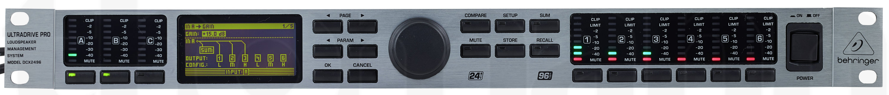

Alternatively there as various "pro" options like the DBX DriveRack PA2, or the cheaper knockoff Behringer DCX2496 Ultradrive Pro. It seems thomann have their own version too, the t.racks DSP 206. One of the pictures of the Behringer shows it does gain and routing per input, which sounds like what you want.
