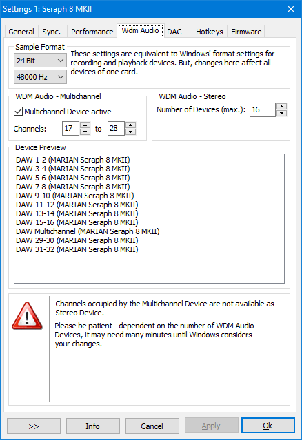

I am using MPC-HC (clsid2 release) to play 7.1.4 Dolby sources pre-decoded by cavernize for now more than one year. I have two cascaded Marian Seraph8 mk2 PCI soundcard in my PC to have 16 analog out, so in theory I can use this system to play 9.1.6 dolby audio streams. Marian has replaced recently the Seraph8 mk2 by the clara A model:
These cards process internaly 32 audio channels. For the end-user, the only thing different between the Clara A and the Seraph8 mk2 is the external TDM SyncBus that provide 16 channels instead of 8 (x2 if bidir) to exchange data between the cards and synchronize them.
These cards have a multi-client driver that supports ASIO and WDM audio/WASAPI clients in the same session. Thus, in the control pannel of the soundcard n°1, I have defined 12 channels for the multichannels Wdm Audio (channels 17 to 28) to play 7.1.4 audio tracks and MPC-HC is configured to use WASAPI on the wdm audio.

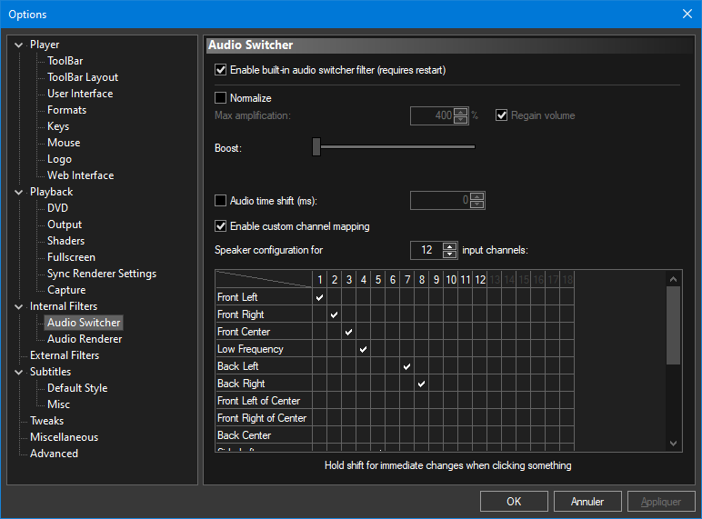

Thanks for the info. FYI, I only use MPC-HC and the channels assignment/order can be forced in it with a matrix representation in a given option. I had to do it, because for 5.1(.4) tracks, I dislike to have the surrounds on the back channels (instead of the side channels) and unfortunately MPC-HC behaves like this by defaut with the LAV Audio filter. It was a little tricky, but finally I have the assigment I want for my HT setup for both 7.1(.4) and 5.1(.4) ...
Does MPC-HC use some sort of add-on component like Foobar2000 (Matrix Mixer) to map the channels?

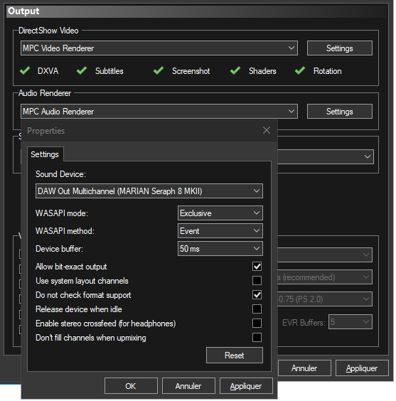

And the "MPC Audio Renderer" must be chosen and configured exactly like this to have some sounds with a Marian soundcard (DAW Out Multichannel, Exclusive WASAPI mode, "Use system layout channels" unchecked, "Do not check format support" checked, "Release device when idle" unckecked (necessary to have sounds after the sequence play/stop/play again)):
