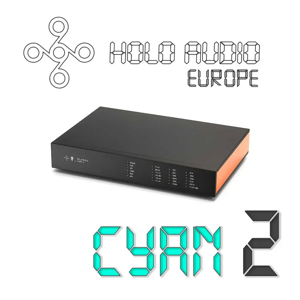

Well, I was trying to learn more about the "vector step resistor network" Holo Audio claims to use for their DSD DA conversion. Google could find only quotes taken from Holo marketing materials, no relevant technical discussion https://www.google.com/search?q="vector+step+resistor+network" . I really wonder what it does, please anyone any more info? How is a resistor network used for converting a single-bit signal Thanks.

Um, the Holo Audio May is an R2R DAC. A very good one, but by definition it’s a PCM device.
Well, this is what the vendor says:
Equipped with R2R network and vector step resistor network at the same time. The R2R network is used for primary digital-to-analog conversion of the PCM stream, and the vector step resistor network is used for primary digital-to-analog conversion of the DSD stream.
That's why I was asking about the vector step resistor network for DSD.
