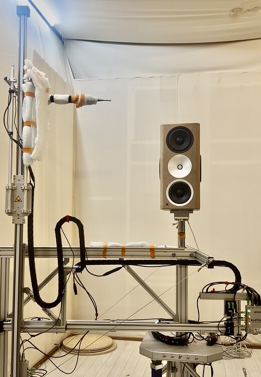

C6C looking mighty impressive... :cool:
We are proud of that results.

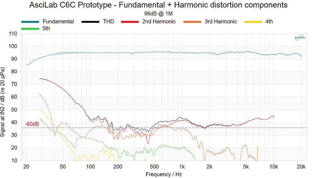

For more information, the H2 below 100Hz will be more lowered than now. Some of customizing is going on.

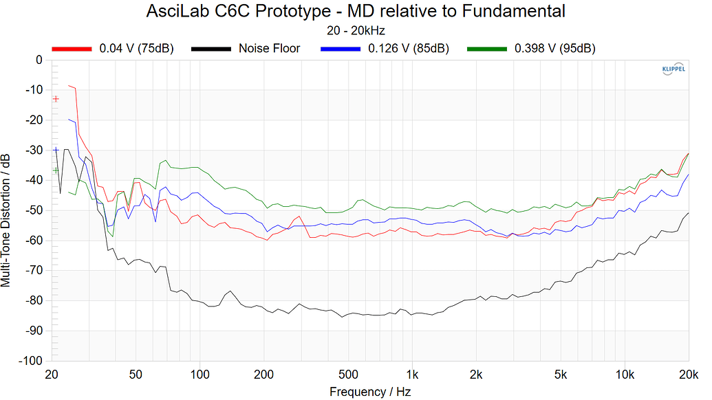

I sort of wish there wasn't this slight compression around 1 kHz for the tweeter, but that we'd probably need another driver and waveguide, and probably isn't worth it at the price point.
Yeah. It would need another driver like Purifi tweeter and different waveguide for Purifi tweeter ;)
The test signal it a sine sweep, isn't it?
There shouldn't be any compression (or less) with music I think.
Also, was it the Wavecor woofers or the final one?
There shouldn't be any (or much less) with music I think.
Multitone compression uses a curve like music curve.
Yes. The side woofer will be customed Wavecor.
is positive y axis value equal to compression or expansion?
