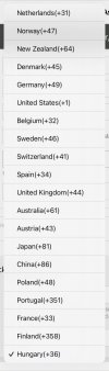

@AsciLab It seems like you are using a shop template and there are some placeholder texts left and some functionality is not used or broken. In particulcar:
  • When viewing a product page like this, there is a "Size info" tab. When clicked, there is no info about the product size, but random text like "We recommend an actual comparison with the clothes you usually wear.". To the best of my knowledge, you are not in the business of selling clothes (, yet?) ;)
  • When scrolling down a "category" page like this, the top navigation bar with your logo and the "hamburger" menu button on the right fully disappears. This prevents any further navigation on your site, until you reload the page (F5). This problem only seems to affect category-type pages. The navigation bar stays visible on all other page types I tested and just gets a bit slimmer when scrolling down.
  • I would suggest that you deactivate the "Review" and "Q&A" tabs on the product pages, as long as those are empty. They are working, but it gives the impression of broken functionality, because there are no reviews or questions/answers, yet.

Thanks for detail report!
We just opened our website and yes, there are still several issues. We are keeping to find out and fix.
In a few days that issues must be solved.
