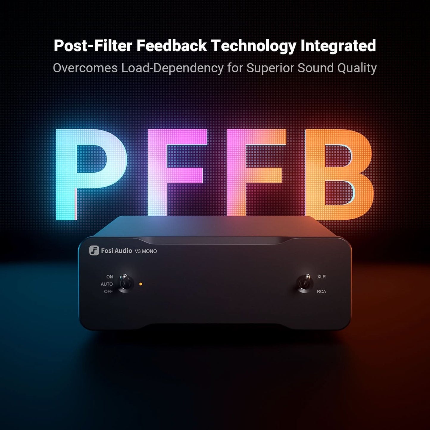

But if you are building a home theater from scratch, then consider getting yourself a very affordable Monolith amplifier.
