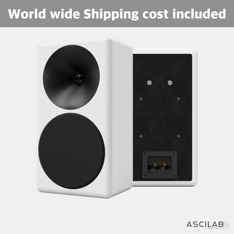

The low crossover frequency caught my eye immediately, and I wonder how they can do that. Tweeter response doesn’t usually extend that low, especially with low distortion. What is special about their tweeter?
Absolutely nothing, they are pretty normal but decent enough tweeters, I know the C series uses SB Acoustics, no idea about the F series.
Deep waveguides are horns, sort of, kind of. They greatly boost the low end output of a tweeter by narrowing the sound cone rather than letting it radiate wide.
We have to do several things to get low frequency.
First, the tweeter itself has to have low distortion. But it’s not enough to get that low xo.
Second, deep waveguide for loading. Thanks to our waveguide the tweeter can get 6 to 8dB more gain around COP.
Third, we use LR4 crossover. To design this low crossover with 4th order slope, crossover components are easy to be expensive because large capacitance and inductance is needed. But to get steep slope, it is necessary.
Finally, we adjust tweeter voice coil rest position. Due to its very short voice coil length, it is very sensitive about asymmetry.
By adjusting voice coil position we can get lowest distortion of that tweeter, especially H2 around Fs. Adjusting range is 0.x mm.
Lot of efforts are needed to produce our products.
I actually think a lower crossover point like this speaker has is preferable. Our heads are about the width of the wavelength at the crossover point, and Horizontal Direction Cues come from interaural time and level differences which transition from one to the other centered around that frequency. At frequencies smaller than the head, >1500 hz, we mostly asses the level difference for directional cues b/c of the head shadow. At frequencies lower than 800Hz, IOW significantly larger than the head, we assess the phase difference. These frequencies are not hard stops and it is thought that there is a smooth/overlapping transition from one mechanism to the other. It could all be inconsequential, but I think for mixing a recording in the nearfield, having near perfect and fairly narrow pattern control above 1500Hz and thus reduced early reflections combined with the large vertical lobe should be the bee’s knees for tone and imaging.
You could reduce all those early reflections with sound absorption, but you’ll also inadvertently kill later reflections and thus your sense of envelopment.
The benefits should still be present further away as well as far as imaging goes. The wide vertical lobe shouldn’t hurt either though its benefits will be minimized with distance.
Suffice to say that this waveguide and choice of drivers makes this a very compelling set of speakers and the same could be said for all the speakers from the brand. You can rest assured that everything from the brand is technically competent thus far.

After looking at F6B, 2 bucks to bet F6Bs resonance is caused by the big flat piece of rear cabinet wall
The rear wall is heaviest plane except baffle of that model. 1kg crossover is mounted on the rear wall. That can’t make the resonance.
Can I get your 2 bucks? ;)
