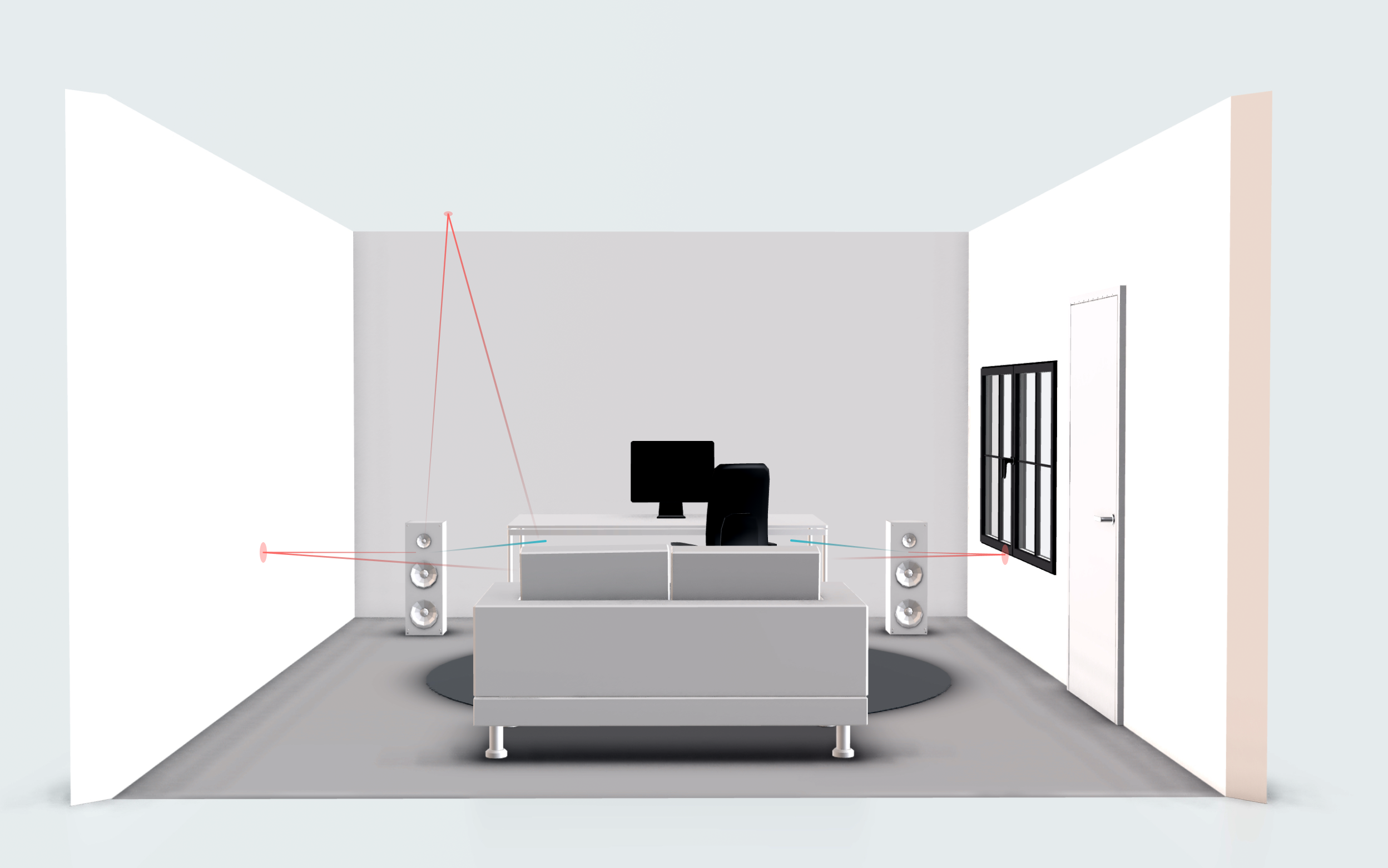

I have a pair of F6B in an 11x12 carpeted home office. Said speakers are located 1' from the wall (windows) and 2' from the corners. According to AsciLab they should be 1'-2' from the back wall. The link below about an SBIR post seems to contradict AsciLabs recommendation.
I really respect the wealth of knowledge here on ASR and would appreciate some advice/input. But please use layman's terms as I'm just a dumb IT guy that loves stereo gear. : >
