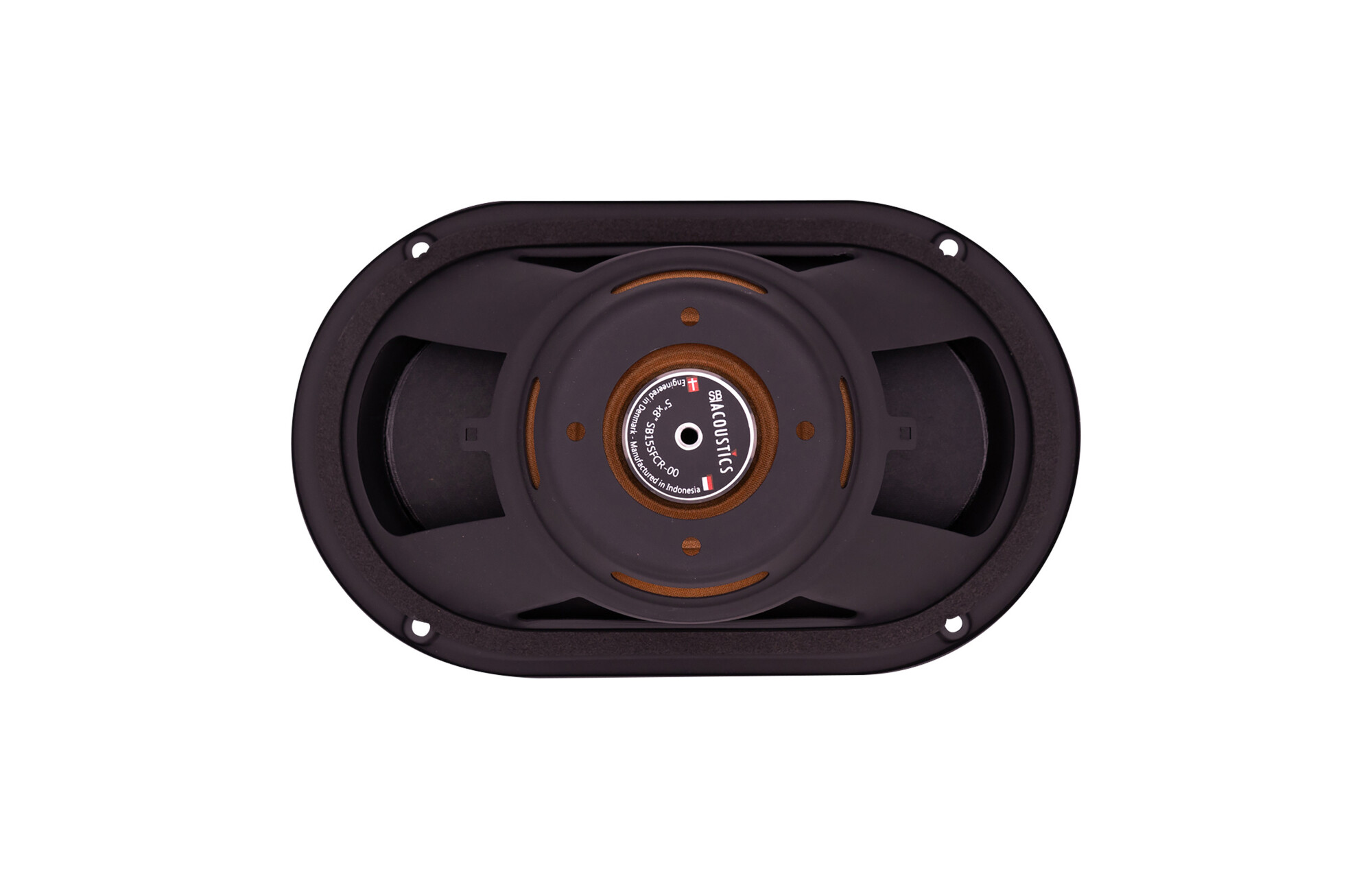

I started really enjoying the speakers after I EQ'd bass for my room.
Then I started thinking why waste free energy so I removed the PR from one the speakers and added extra weight.
EQ flat, I compared the speaker to stock and the difference was way beyond my expectations. The extra weight made the speaker go deeper and removed the unwanted bass, it also sounded much bigger. I added the same weigth to the other PR and am very happy with how the c6b sound in my room.
Absolutely no need to mess with subwoofer(s) what I initially had planned.
You removed the passive radiators and added weight to the top of the speakers?
Can you post a photograph?
No I am not opening it up again.
The PR is the 5×8″ SB15SFCR-00 / Paper
This picture should be pretty self explanatory
There are 2 disks (10g and 5g) bolted (m6) to the PR, I added 10g.
Cool. Interesting. In room measurements would be cool and interesting to see.
FYI, this will shift the PR's resonant frequency down, extending LFX but leaving a hole in the response where woofer and PR cross over.
