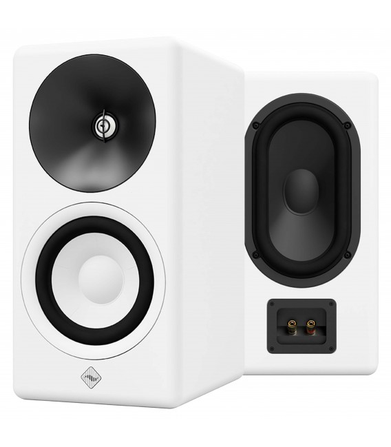

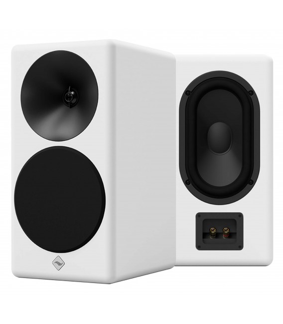

I am really interested in the C6B, all white looks quite good and tempting.
Personally, I would not use the C6B without a subwoofer in a living room or dining room. I mean a room with a fairly large volume)
Which would be true for every two way compact design ever created.
