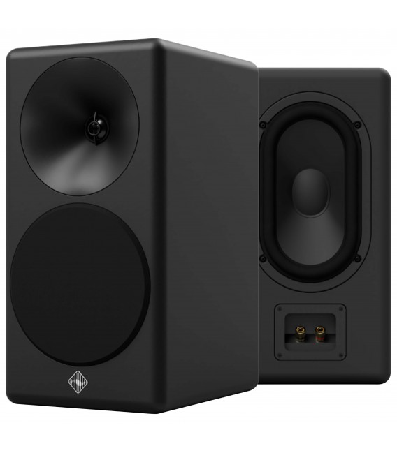

It's clear ) I think it's worth waiting before investing in a pair of F6Bs. In any case, that's what I would do )
Ascilab is a startup : even more interesting products are yet to come
That's done ! I I checked Audiophonics website this morning, and they're distributing Ascilab speakers from now on, with a very moderate increase in price ! Great news indeed...
