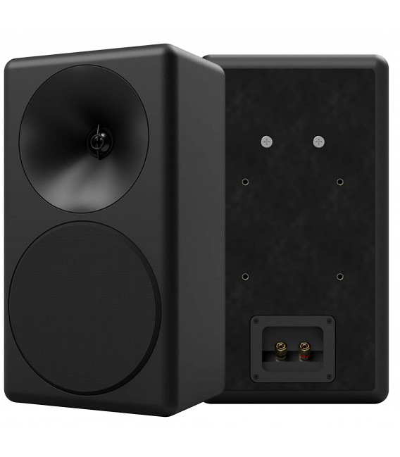

Thank you again and always amirm -- your reviews and site continue to set a high watermark and it looks like you are deservedly even more widely loved than the last time I posted here! The AsciLab does look outstanding objectively and empirically and it's about time someone stepped up and just did it! It's also very cool to see passive radiators used again for all the engineering problems they can solve and with good execution as they're not cheap. But I haven't been able to find anything revealing if the grilles are in fact designed to be removable, or if there is or will be a grilleless option for the F6B like the is for the C6B -- perhaps someone knows or Mr. AsciLab can chime in?
Thank you for kind words.
Our C6B has trim ring as a default option, and it can be changed to grill.
F6B has grill as a default option, and there is no trim ring option. The grill can be detached but it is designed for maintenance only. So we recommend not to detach them.
