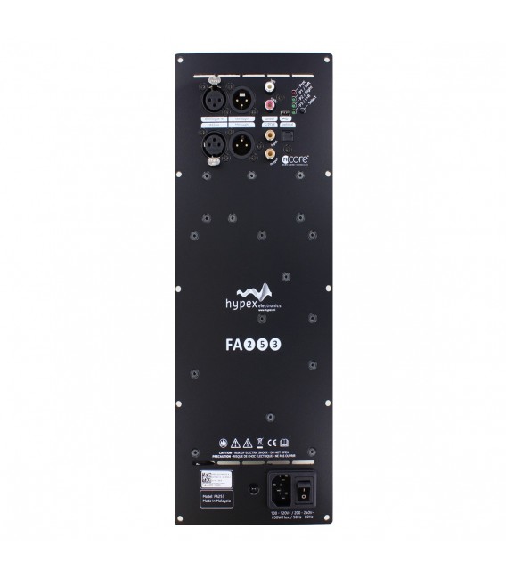

To conclude this discussion on the obsolescence of this product, let's ask @AsciLab ...
if the Hypex FusionAMP FA253 module used on the C8C is no longer manufactured in the event of a future failure and if the monitor is no longer under warranty:
-> are you able to provide software support to configure the DSP to make the C8C functional with another Hypex FusionAMP model ?
-> Will this change be feasible for a novice ?
If so, we will face the same problems as with a pair of passive speakers and separate electronic components.
