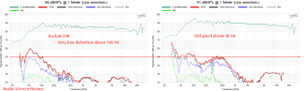

Let's jump into distortion because that is what is unique here with respect to woofer upgrade. I will start with a comparison against F6B:
Ascilab C6B bookshelf hi fi stereo speaker relative THD distortion compared vs F6B measurement.png
We see substantial reduction of distortion in upper bass and midrange relative to lower cost woofer used in F6B. However, there is an increase in distortion at very low bass frequencies. I don't know why that is the case but overall, this is an excellent improvement over F6B.
Here is our standard graphs:
Ascilab C6B bookshelf hi fi stereo speaker relative THD distortion measurement.png

You can see how the 101 dBSPL is not usable given its massive distortion. Woofer distorted some but it was the passive radiator that bitterly complained. I heard a bit of distortion at the start of the sweep at 96 dBSPL and we see the reason for that: non-linear rise in distortion below 42 Hz. This is very typical even in larger speakers.

It seems to me that the distortion is quite high, especially below 100 Hz -- and above too, though I never listen at 96 dB. The price is very reasonable but that distortion would give me some pause if I were looking to buy speakers in this general category.
It seems to me the distortion is not sufficiently recognized. Great FR is nice, but minor FR deficiencies can be compensated by EQ or FIR filtering. (As I understand), FIR filters can also compensate for some time domain issues, but neither EQ nor the latter can compensated for distortion.
