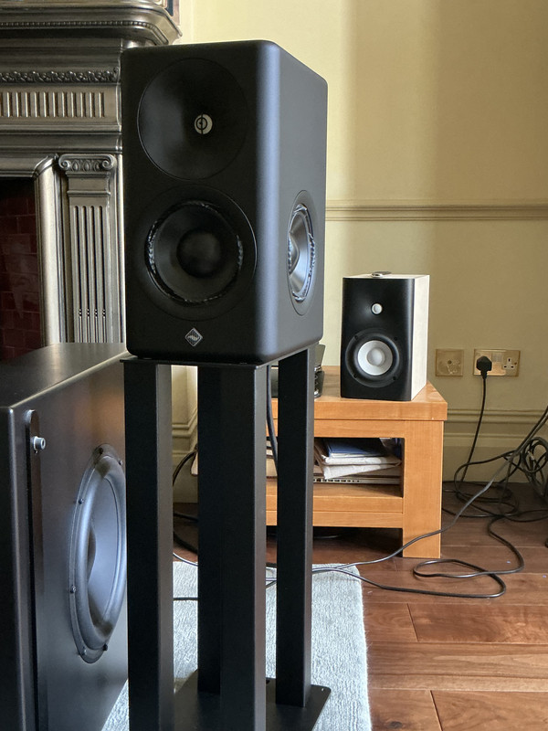

The acoustic centre I believe is between woofer and tweeter, so a stand whose height brings the speaker up to that position, usually around 60cm.
You'd need tall stands to get your ears between woofer and tweeter.
I've got your C6Bs on home loan and they're on 61cm stands, which with spikes/ spike cups are 65cm tall. The point between woofer and tweeter is 23cm from speaker base, so that's 88cm on my stands. I sit on a low chair, and I'm average height, and my ear level is still 100cm (tweeter level). I'd need either 70cm stands, or to sit on the floor to be at acoustic centre!
However, looking at the polar plots I don't think it's too critical.
When I measured here, ear height, minus the distance between the base of the speaker and its acoustic centre, the distance and thus height of the stands was 60cm.
I use these ‘Custom Design’ stands, they are robust and stable and not too expensive.
