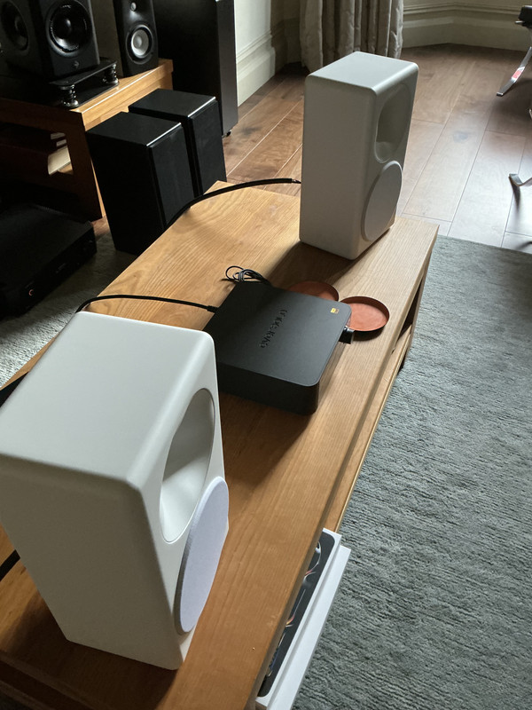

I have tried the Eversolo ‘PLay’ with the C6B ( no photograph) and the F6B, F6B/S they work fine, this is however listening relatively close 3 metres maximum.
Eversolo Play and white F6B/S,
