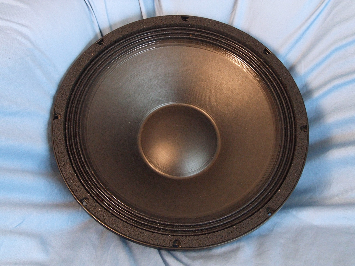

12"+15" in the W371. It's possible to argue about sonic properties of 15 vs 10 inch. I've owned 4x10" speakers, and I prefer 2x12" even. (Different designs, so not comparable in actuality.)
It has to be compared total effective volume, Sd x Xmax. Not only inch.
For W371A, AFAIK they use B&C driver. 14” and 12” (though I don’t know they are customized). Both of them are measured by Voicecoil magazine.
For front woofer it has about 6200cm^3 excursion volume. And the rear woofer has about 5000cm^3.
For PTT10.0X, it has about 5300cm^3 excursion volume and even with better (x) curve. Well not just better, the best.
And we use 4 drivers in a single speaker.
Then it will be more than 21,000cm^3 total effective volume.
I know all these math can’t be the only parameter to justify the sound quality, But also I know it is undeniable factor.
With superb cardioid pattern, I can’t imagine better ideal option to compete to this structure as stereo system. Someone can say multiple subwoofers, but Multiple subwoofers are not the topic for now.

That was the answer about yout 10" vs 15"(actually 14") comparison. In similar Q and Fs, multiple drivers can be regarded as larger Sd, same SPL with less excursion. This can result more linear excursion=less distortion. And I don't know why our conversation is going to "with GLM" option. Aren't we talking about woofer capability?
I was talking about the complete package, what it delivers and not. In my opinion, and since I'm not an engineer, so there's a limit to how technical I can be. But if you set up coaxial, vs waveguide vs flush mounted flat baffle, there will be major differences, but the waveguide and the coaxial will be most similar. I know from direct comparison.
About 15" vs 10" let me direct you to a different answer. In 1978 Richard C. Heyser wrote "Hearing vs. Measurements".
