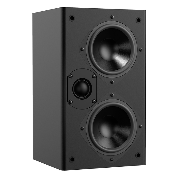

Would there be any dispersion concerns for horizontal orientation as the tweeter cannot be rotated like the Sierra series?
This tweeter is rotationally symmetrical, so there is no concern. All dome tweeters we are now using (this includes our Titan dome tweeter in our Sierra series) are rotationally symmetrical.
Is there a non-obvious reason SEAS uses a truncated faceplate on this model tweeter that is rotationally symmetrical?
It isn't SEAS that uses the truncated faceplate, it was per our specifications. We spent a fortune tooling the faceplate so that this excellent tweeter was a drop-in replacement for the Audax tweeter we used in our original 170 and 200. The truncation is necessary for our HTM-200.
I should mention, this is a fully custom tweeter.

It isn't SEAS that uses the truncated faceplate, it was per our specifications. I should mention this is a fully custom tweeter.
As I'm sure you are aware, SEAS has several stock tweeter models available with truncated faceplates, so the "custom" aspect is not really the faceplate I would presume (as is the standard sized circular faceplate of the Sierra model).
I think hat Ascend Acoustics simply took the Seas 27TFFNC/CG tweeter, removed the honeycomb grilles, and likely made slight modifications to the design.
Stock spec
