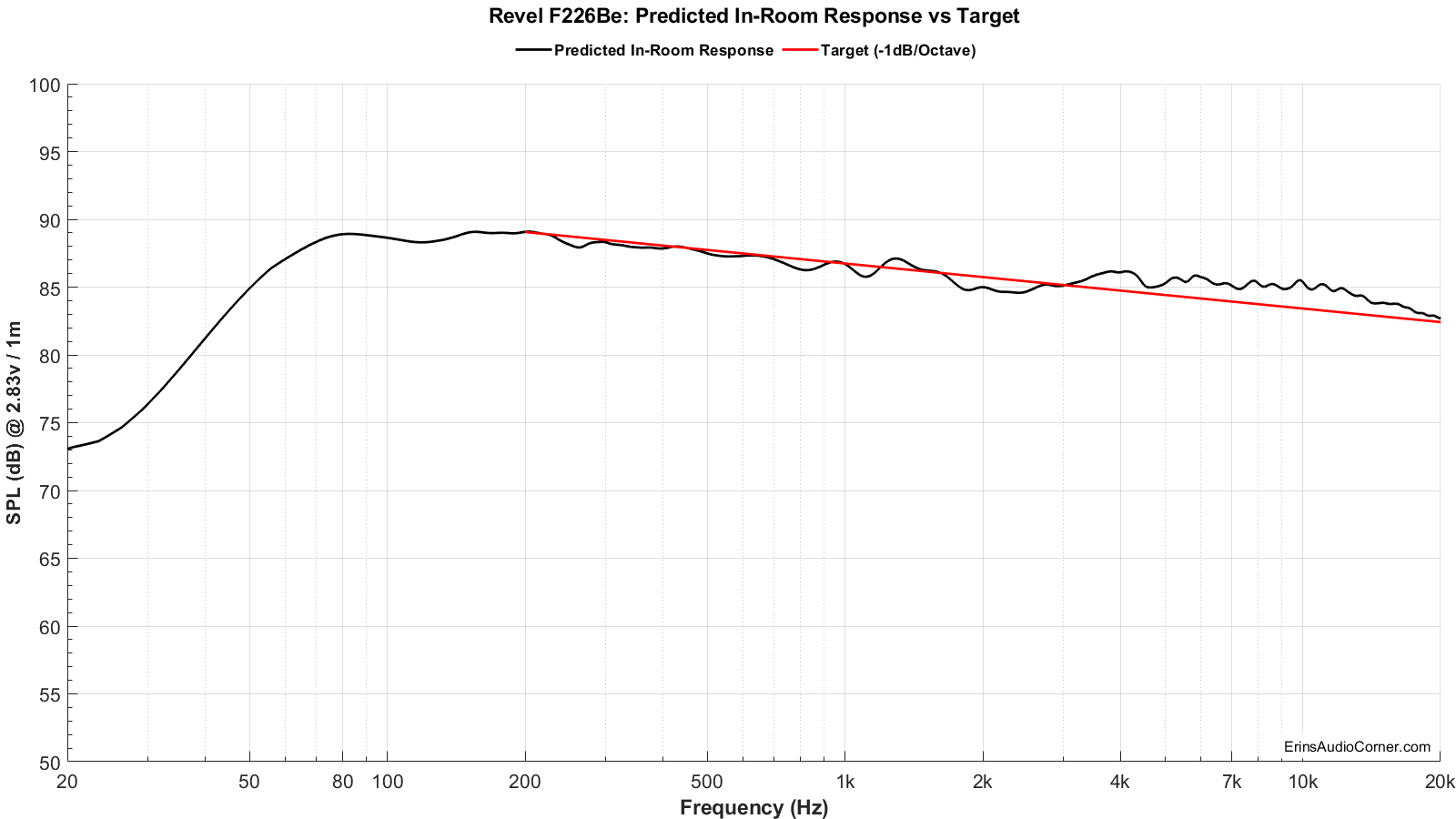

Anyway, it all goes back to balance to me. A speaker that is too lean or too heavy in mid to upper bass will not sound as composed with many more complicated musical passages as a speaker that is largely flat across those frequencies. This, along with dispersion and raw SPL of course, can also impact the impression of scale or "size". A bass-lean speaker (or one which shelves up mids/highs) will sound less full and impactful as certain instruments / vocals / effects will be perceived as recessed. You can see the silky-smooth mid to upper bass response of the F226Bes in Erin's measurements:
Here are the original RAAL towers in comparison:
index.php
index.php
When Ascend releases the spins for the new RAAL ELX towers, you'll see that the response top-to-bottom is far flatter while maintaining excellent directivity.

Apart from a lack of free time to complete a detailed write-up at present, the primary reason that I'm currently being rather vague and broad in my impressions is that I would much prefer the Klippel measurements for the ELX towers and Horizon to be published so that my subjective observations can be correlated to the data. I found there to be some differences between the Ascends and the Revels to my ears that I'm not fully understanding when I attempt to translate them to the measurements of both speakers, and I'll be interested to read others' thoughts.
