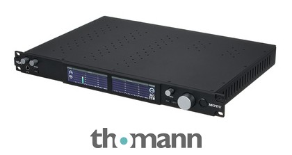

This has 16 analog channels in and 16 analog channels out:
For that capability, I would call it "affordable". One could easily use up this many channels with a DSP crossover for a line array or CBT loudspeaker, including the shading.
Not affordable for me
Especially compared to a couple RPi 4b plus 8ch HATs, when that includes the compute as well.
