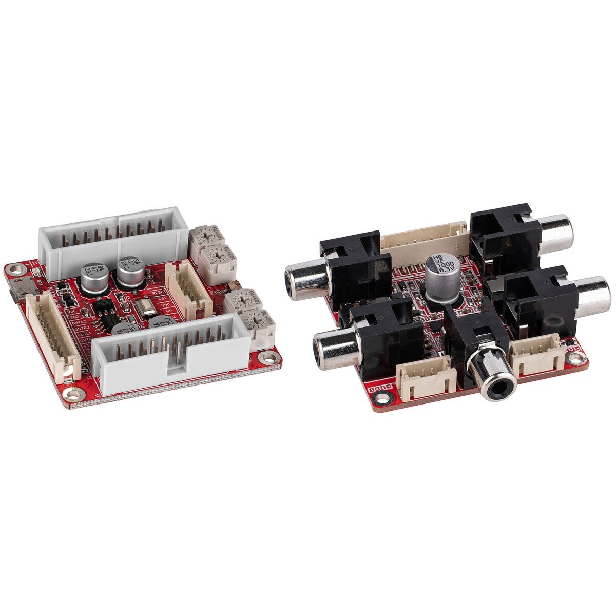

DIY active speaker systems are not so common.
If I was going to design some speakers, I would build them active 1000000%. That way you can easily fine-tune the crossover of each individual driver. You just can't do that with a passive system to make it worth it.
You could easily design some based on this board (I have a friend running his linkwitz 521.4's on this)
or a bunch of eval boards that would work depending on your input/output needs
Or you. could pick up a couple of these for each speaker to do a 2/3 way
I use one of those^^ for my 2 speakers with passive crossovers (C-notes, the ones in my picture)
Then a 2 way or 3 way. If 2 way you could even use a minidsp 2x4hd too.
