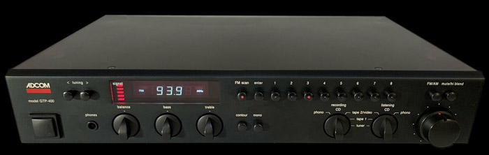

I was comparing the front panel Adcom to the Braun/ADS gear in post #17 not the Apt. Otherwise yes, I agree the Apt has more features. :D

Agree. I also have the ADS CC4 , CD and cassette.I‘ve always liked the styling of Braun components.

CC4 looks like a tidy pre. Nice and clean front panel. There are very few details and pics on the web for it and it has no blue LEDs. I like that.:D
