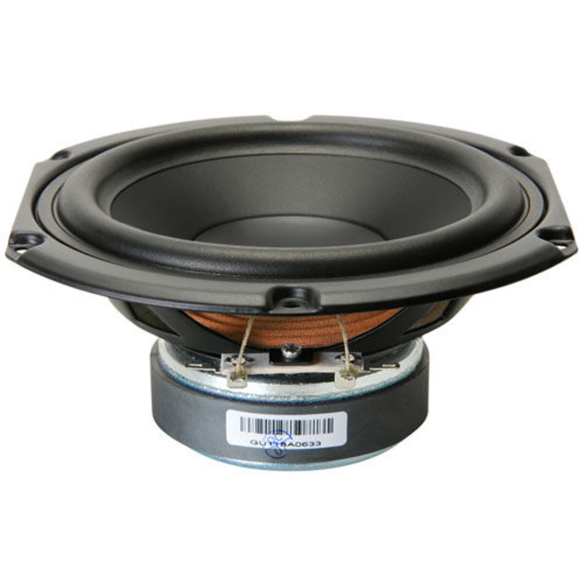

Drivers are clearly generic Peerless by Tymphany OEM models. The way they are designed is very typical for them. But that is not a bad thing as they make great drivers for small budgets, and it's a sign the speaker designer knows at least a bit how to design with a budget in mind. No need for special snake oil blablabla, just use what is needed and don't try to reinvent the wheel...
I immediately saw the SDS series woofers, (Maybe?) the ones that are about 20 bucks a pop right?
The cones look different though............
The tweeter, I am not sure what it is.
But those budget Peerless/Tymphany midwoofers actually measure and account for themselves quite well for their price!
It's probally not of the shelf, as the frame is also slightly different than most peerless designs of today. I saw OEM drivers like that that were called FSB aand some series of numbers that i don't remember in a design that i can't talk about yet (still in dev by someone i know). It's probally not exact the same as used here, as the OEM build from that guy is custom. Custom OEM drivers is the main bussiness of Peerless (and a lot of driver manufacturers), the diy part is mostly advertisment that also gains money for most. Very few driver manufacturers work only for the diy market.
The tweeter looks like a OX20SC02-08 in a custom housing with grille, or at least something similar.
And yes, that SDS is incredible value for money, just like most peerless drivers. It's only hard to find as the company sells them only in big numbers to distributors, and most distributors don't sell enough to diy people to justify such big orders.
