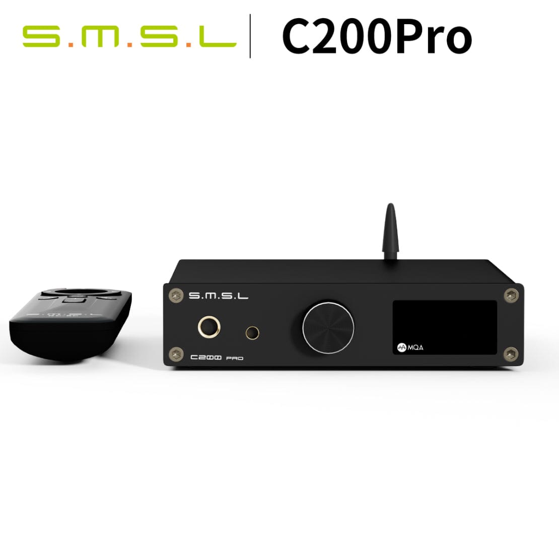

Looks like C200 pro has been released
Some updates
Nice, so the DL200 in a C200 housing.
SMSL R&D department running at max capacity :D
Maybe they get the filter names correctly this time?
So other than slightly better SINAD, are there any meaningful differences? I’ve been thinking about picking up a 2nd C200 to replace my aging Octavart O1.
I dunno. Looks like the screen is updated as well.
I'd be more curious about the new one.
Maybe one thing the original is not so great with is how easily it picks up if a cellphone is close to it. I expect at least this part to be better.
Another thing that is likely better is any warranty cases with the new one..
That was never an issue with the C200. Now with the ES9039, it may well run the same firmware as the DL200 since the UI seems the same.
