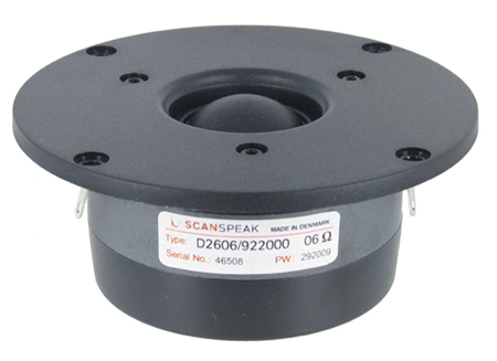

Or this Scan Speak::
Both Peerless and Scan Speak have dramatically similar responses to each other, on-axis and off, and similar specs by their spec sheet. It would be good to see what the model is of your original tweeter. That's if they are original. It would help to see if these are indeed drop-in compatible.
The tweeter (and mid for that matter) are going to be easy to blow if overdriven. If the Peerless or Tympany are adequate drop-in replacements, you can get spares!

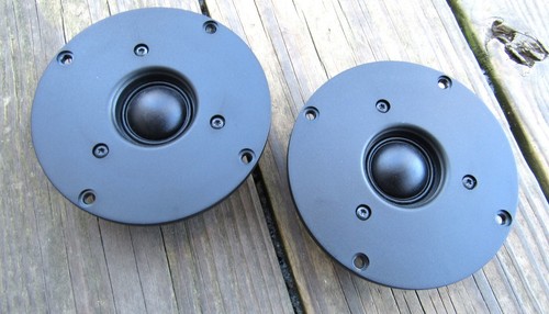

I found these new old stock. Never know if they're actually new.
I'll probably get them and test
Good start.
The D27TG05-06 have response that is almost identical to the current Peerless D27TG35-06 and the D2606 Scan Speak.
If and when you demount the existing tweeters, you can also remove the diaphragm and look inside to see if Dunlavy added additional absorption material in the cavity behind the dome (it says he did in some of the reviews). It likely won't be a big difference from the stock tweeter's response, but may be worth considering transferring any modifications to a pair of new tweeters. Or even getting replacement diaphragms for the existing magnets.
I forgot to mention, these are all ferrofluid tweeters, it is possible the tweeter is dead not because of a burned voice coil, but because the ferrofluid has dried up and turned to varnish in the gap. In any case, in your communications with the seller, please ask if the tweeters are original. Will be nice to understand if they are the original Dunlavy-modified pieces if only to understand the if he is doing some special treatment in the cavity. Note, if the ferrofluid is indeed dried completely, it is exceptionally difficult to remove from the gap and you likely just need to replace the entire tweeter.
I would make keeping these contingent on figuring out first that you can order equivalent tweeters, which will likely involve you demounting at least one of the existing drivers to check model numbers and likely sourcing a replacement unit to check fit. I actually think this is doable, not expensive, you might end up with a collection of tweeters and some new confidence on fixing things if that helps. And likely see how a great sounding set of speakers is constructed from pretty average drivers (despite the woo woo stuff about esoteric bespoke drivers fabricated from rare and exotic materials). And I am hoping for lots of pictures, including potentially the crossover so we can figure out the actual crossover frequencies!
But first, you have some business to sort out with the seller. :cool:
