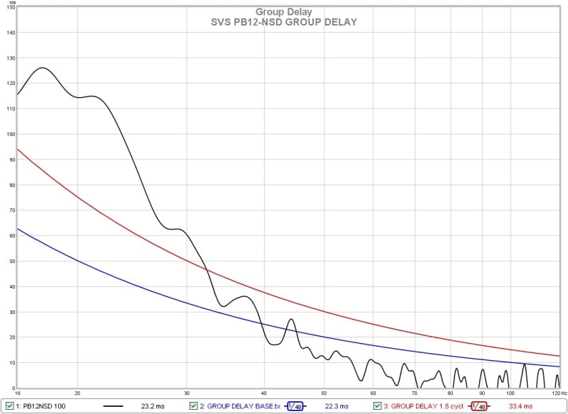

I have started porting my data from Klippel over to the google sheet. I am including the following data:
  • Max SPL CEA-2010B results
  • FR (normalized at 100Hz, 100dB) (because max SPL is per a given frequency, but the linearity is of concern as well)
  • Group Delay
Now, I'm only 5 subwoofers in and I can already tell this is going to be messy in a year's time if I keep this up. But, luckily, one can filter the results and the plots will change dynamically. So weeding through results should be less daunting if someone has a specific size, budget, SPL, etc they want to achieve.
Here's a sneak peak.
Cool!
Are you able to add the 1 & 1.5 cycle curves?
Those subs you measured seem to have pretty good group delay, which I find odd.
Cool!
I could, but I'd have to output them in to REW and then export the data. Which means additional work and I'm not sure I see the merit, to be honest.
