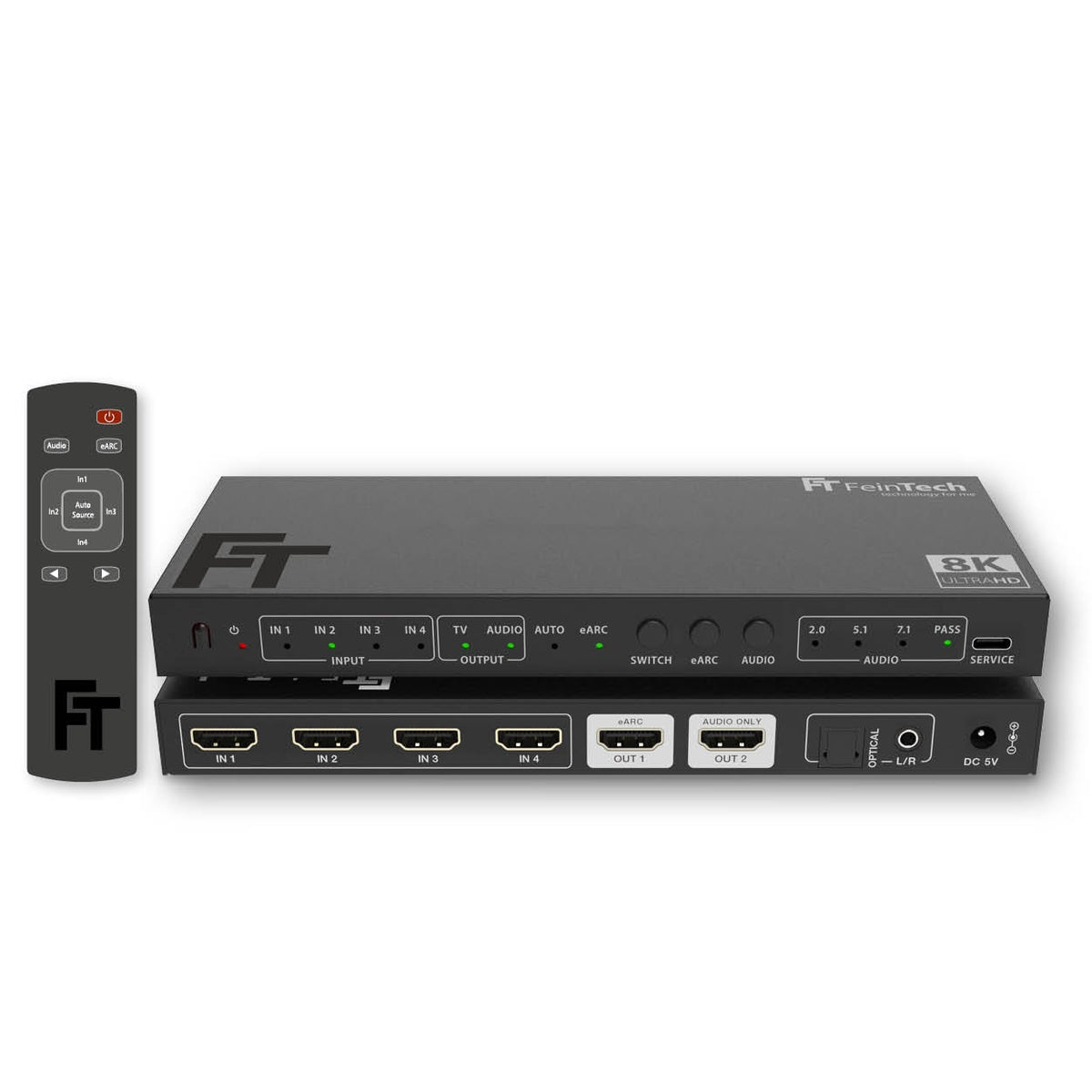

Won't work. According to the website, "
  • AUX (L/R) : Only the stereo signal (2.0 PCM) is output here.
  • Toslink (optical) : Offers the ability to output stereo, Dolby Digital, or DTS—ideal for older sound systems.
  • HDMI Output : The HDMI output supports all common audio formats and is ideal for passing the sound to a modern sound system with multiple HDMI inputs (such as an AV receiver or soundbar)."
In other words if you're watching Wednesday on Netflix, which is Atmos, the HDMI will be the only port outputting if your EDID is setup correctly (the stereo and optical will be disabled due to bandwidth). You need a downmixer built in. The HDMI will output Atmos, but the Wiim Ultra only accept an HDMI Arc output and thus won't accept the HDMI NON Arc output from this device. I've been down this painful road. Now before saying, well connect it to the EARC output of the device, that won't work since it will be taken up by my EARC Soundbar.
